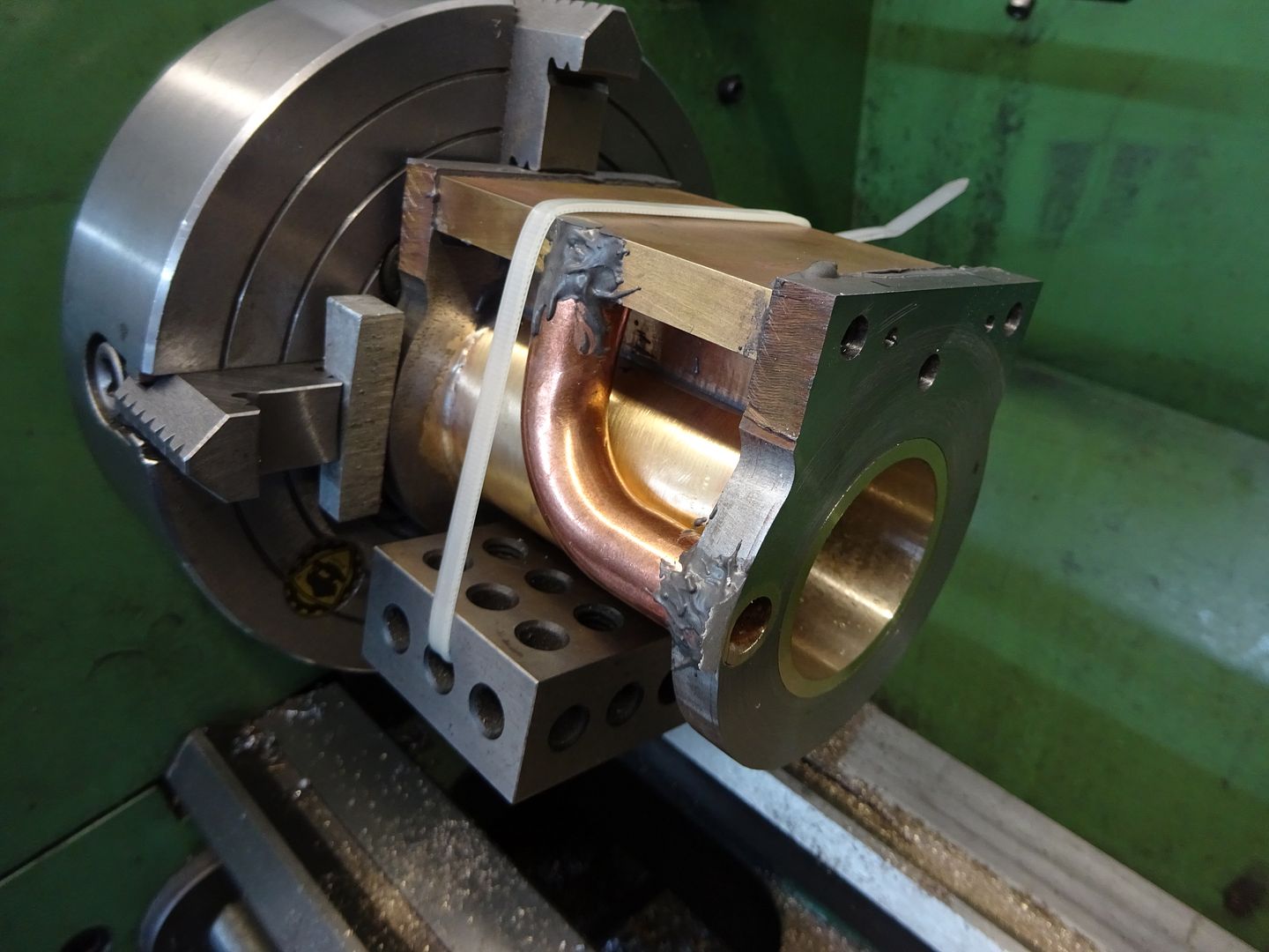

With the JBWeld set on the Tidman cylinder it could be treated like any other casting and bored & faced to size.
