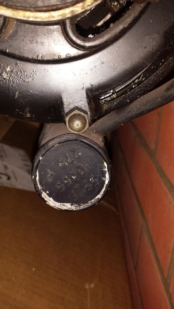

First issue is (and has always been like this) when I start the lathe, it trips out the main fuse in the house.... now, I know this is dangerous what I'm doing, but the way I got around it, is to spin the flywheel on the engine by hand and then hit the start button - never fails. not ideal, but seems like if the engine is spinning then it wont trip out.

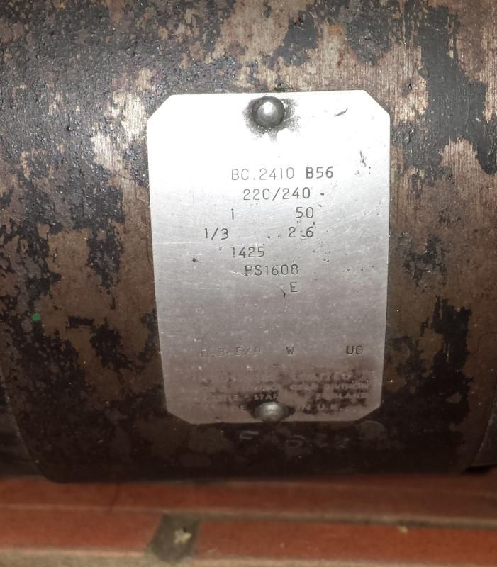

Usually if you have to spin a motor to get it running it means the start capacitor on the motor needs replacing. However, you say it trips out the 'main fuse' - by which you could mean an MCB or an RCD. If it's an MCB, it just means you're trying to pull too much current (what rating is it?), and that seems to fit with your symptoms . If the RCD trips then you have a leakage to earth somewhere, and may indicate a bigger problem than just a blown capacitor.
More info needed on what motor you have (presumably single pahase, but how many kW and how many capacitors), how long a run for the cable between the consumer unit and the motor, and do you have a proper DOL starter fitted?

I am not surprised the trip goes if the starting capacitor is blown, you are just placing the running windings across the mains which will draw high current because there is not a back EMF (voltage) from a running armature to oppose the applied voltage. Fix the starting first..

Before you go out and spend your money, remove the motor onto the bench. Scratch mark both end shield end, two across on the drive shaft end and one mark across on the no drive end. These marks are for easy reassembly, get them right and the motor will revolve freely, a flick on the shaft. Remove the through bolts and using a hide face mallet give the stator a sharp wrap. Carefully remove the rotor and store it carefully on the bench, don't let it roll off and bend the shaft. Have a good look at the centrifugal switch mechanism which is on of the motor shaft, the bob weights or what ever is used on your motor, should move freely and spring back after being moved by hand. Next check the switch contacts to see if they are clean and are not just blobs of weld, these are normally attached to the no drive end shield of a British made motor. The contacts can be cleaned up a bit by using a piece fine of wet and dry folded back to back. To test the windings you will need a multi meter on the OHMS range. There are two windings, start and run. The start will be thin wire compared to the start and will have a much higher resistance maybe 20 to 40 ohms. The run winding could be up to 10 ohms but more likely 4 or 5. Not all lathe motors have capacitors, especially if some one has changed a motor to one that was available at the time of need. Unfortunately there's not an easy way for the average person to check a capacitor other than to change it, like for like and it might not be the capacitor faulty after all. Electricians use their MEGGER to charge up a capacitor, then leave it for a few minute then discharge it by shorting out the terminals using a screw driver, if it give a loud crack they say it good, but how good. Do be carefully when re assembling the motor, its very easy to damage the windings, and look out for those marks on the stator. John

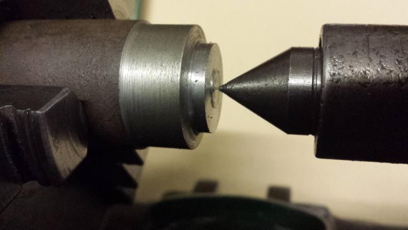

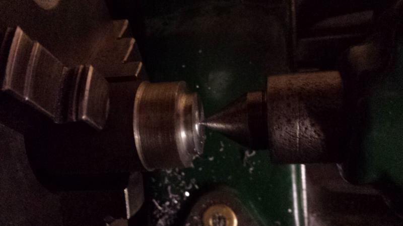

Just thought of putting some photos up, on something I thought, correct me if I'm wrong please.
So what I've done was set my facing off tool in the tool post, slightly below what I think is the centre, surely by doing this it would not face perfectly and leave a little pointy bit on the round bar...this little bit would be where the exact centre is?
then I brought he tail stock with a dead centre on it and tried to match it to the pointy bit on the bar.... would this work?
I did read about mounting a dead centre on the chuck but I dont have one that is not tappered, so I'm guessing it wouldnt stay completly dead centre, right?
you can just see here, the little tip out of the round bar
and from above
I also took some photos of the motor
Sorry, not much info, just in a rush at the moment, will come back later.

If you are happy to work by eye (OK for non-critical stuff) turn a 60-degree point on the bit of stock in the chuck and match that up to the tailstock centre, much easier to judge by eye. Better still try and nip a steel rule between the two, when it sits straight they are lined up (don't sit the points in the graduations).

Neil's method is the easiest way to check alignment but also check for horizontal alignment with the same set up turn the rule horizontal & eyeball the rule from above & it should look straight across the bed, parallel with the chuck, thus confirming vertical & horizontal alignment. Going back to your tool centre height; one easy way to set centre height is to face off some material & look to see if there is a 'pip' left in the middle of the faced off surface, if so then adjust your facing tool up or down to get rid of this 'pip'... tool height centred yes .

Thanks everyone for the tips on the alignment! think I got that one right now, i'm happy with the results achieved.
Now in regards to the motor.. maybe a good start just to change the capacitor? they dont seem very expensive, although I cant find one exactly like the one I have on the motor

For the capacitor try here **LINK**# a phone call should get you sorted

I found this one on eBay that would probably do. (You need to select the 60 uF type.) If you spend some time searching you might find cheaper ones. I did find some cheaper but they had pus on connections. I think one with a length of cable will suit your application best.

I think it is worth following John Fletcher's advice as I think it is more likely to be the centrifugal switch causing the problem. Even if the fault is the centrifugal switch it may be worth replacing the capacitor as the one in the picture looks very old.

got the capacitor on order now
thing is, the lathe was working fine at the sellers house, but then again his fuseboard might have been better than mine or something might have got damaged when in transit to mine.
I'll try the capacitor and then go with Johns advice
