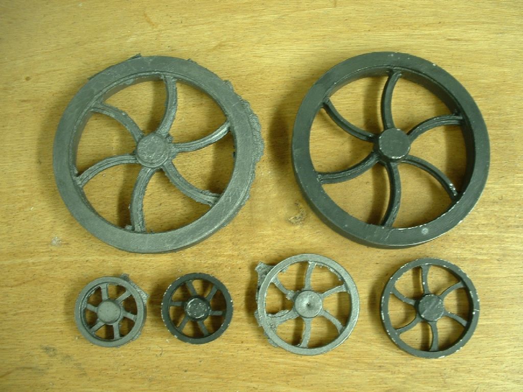

I've had no problems in aluminium alloy or cast iron. I turned the patterns in the photo below on my home-made rotary table, and the other photo shows profiling a steam engine cylinder.
I also turned v-pulleys for my lathe (when the motor went pop) using the mill so both the rotary and cutting elements of what you propose are quite practical.
