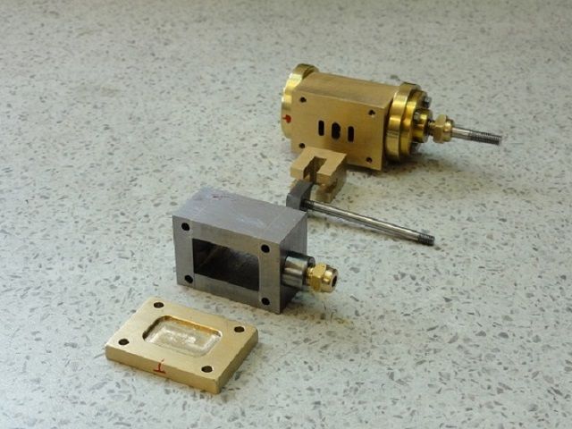

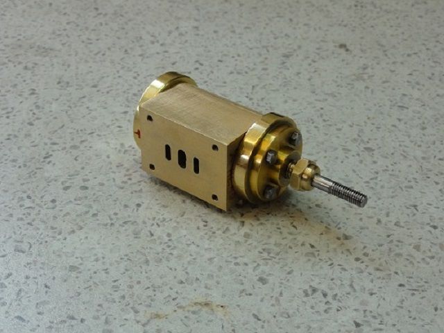

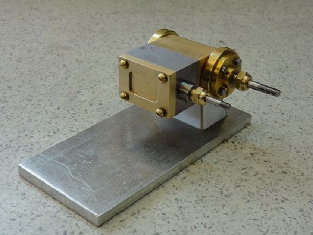

A little more progress on the Popcorn.
The cylinder with its end covers, piston and piston rod
A cylinder family shot, note the extended steam chest to cater for my error in making the cylinder incorrectly with not enough meat on the valve face. I fabricated the steam chest as I didn't have a milling cutter that was long enough to carve out the middle from one side and also small enough to form small radius corners. It is just possible to see the silver solder joins.
And finally the cylinder assembly mounted on a gash bit of aluminium on which I intend to practice engine turning when I get a round tuitt.
I will be making provision for the air/steam inlet to the steam chest a little later in the build when I come to make the inlet manifold.

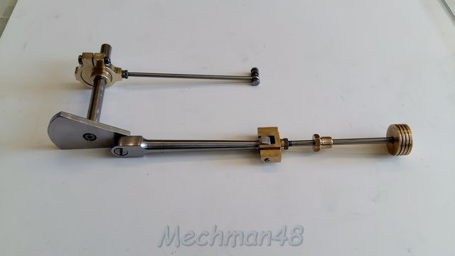

S50 some more...
​Machining eccentric
eccentric & strap polished up...
eccentric assembly...
​Crank, eccentric, valve rod, piston, crosshead assembly
