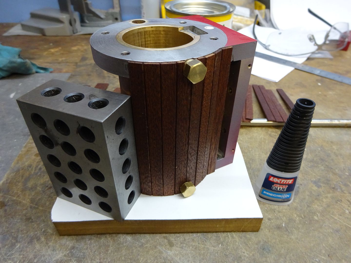

Nick_G15/01/2016 18:06:13
avatar
1808 forum posts
744 photos
Posted by JasonB on 15/01/2016 16:17:51:
I see the postman had some paint left over from doing his boxes. Looking good.
blush
I admit it is a bit on the red side.
I picked it from a swatch at a local place near me that will mix the satin paint into an aerosol. - I was sure it looked darker / crimson on the swatch.
I also took your advice and have given a couple of coats of satin lacquer of the type used on motorbike petrol tanks.
Rounding off and reducing the size of the cylinder flanges and getting the size the same as the valve chest was a bit nerve wracking but went smoothly once I had grown a pair to actually do it.! - Again I took your advice and made them smaller than the end covers so that the wooden planked cylinder will flow into them.
On the subject of the wooden cladding. I was thinking of attaching them with super glue then staining / sealing them with linseed oil. Is this a good idea or bad.? Then to trim them up with brass banding.
Nick
JasonB15/01/2016 18:20:45
avatar
25215 forum posts
3105 photos
1 articles
Thats what I did on the Tidman. The other option is to stick them all onto a piece of linen (old hanky) making sure not to get glue on the edges. Once dry this can be wrapped around the cylinder and then the banding will hold it in place.
