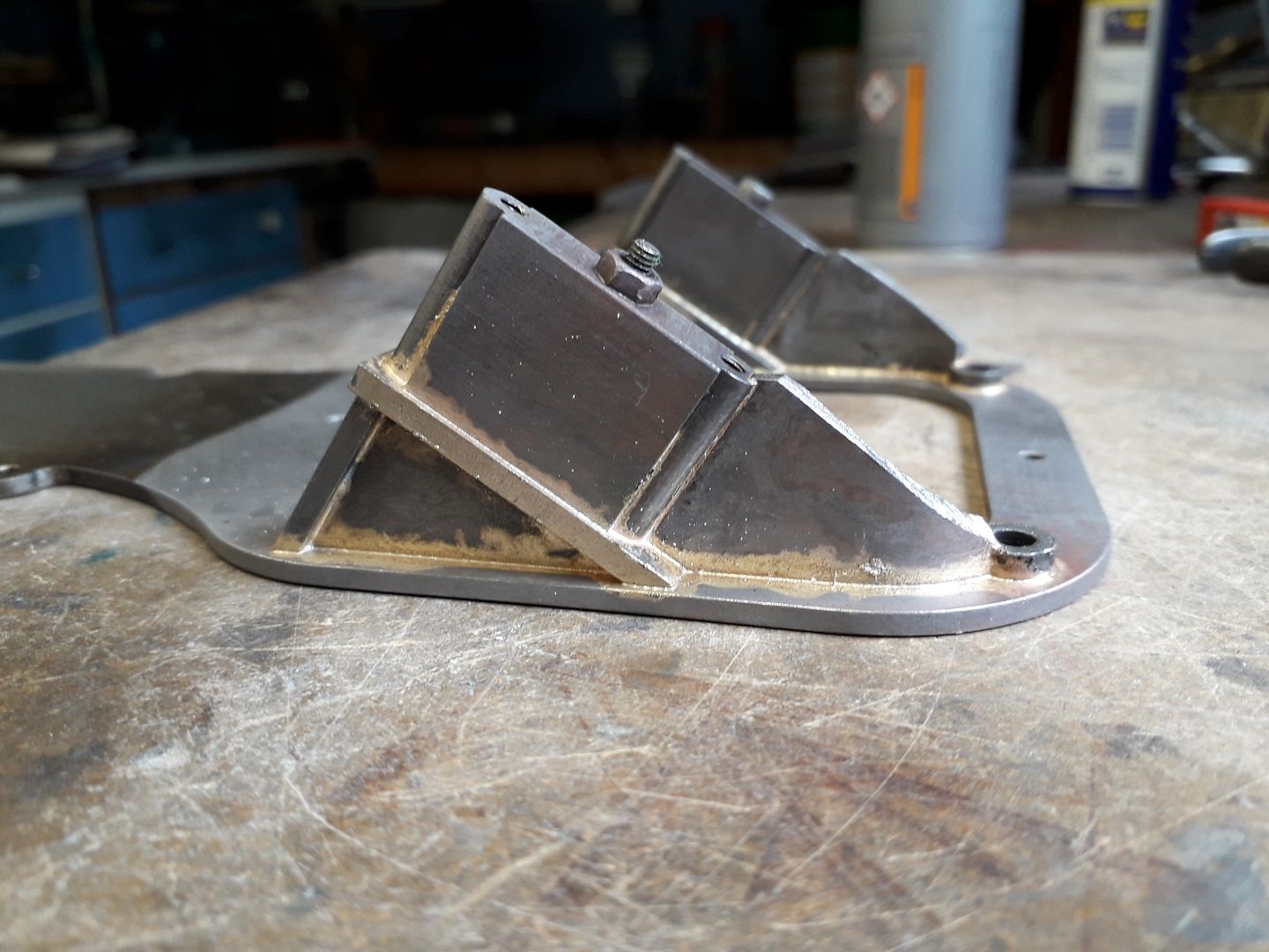

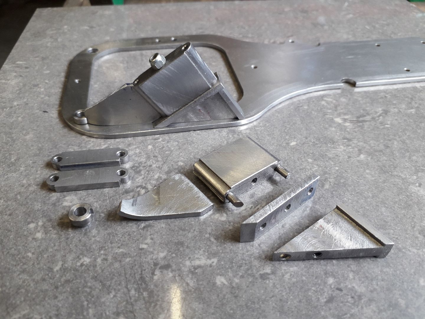

I've been machining up a few more bits for the mill engine I posted in the KX-3 thread that will make up the bearing housings.
Then heated them up with a bit of flux and silver solder thrown in for good measure
And after a 40 min soak in brick cleaner the solder looks to have flowed OK. Just need to file the two curved webs to shape now.

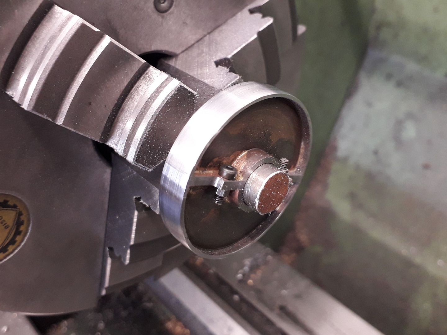

Yesterday i made a split pulley to drive the mill engine's governor, was happy that it held on the 10mm PGMS shaft for final turning and crowning of the face. 40mm OD and M2 temporary fixings, just a bit of filing to round off the flange around the bolts to do.
