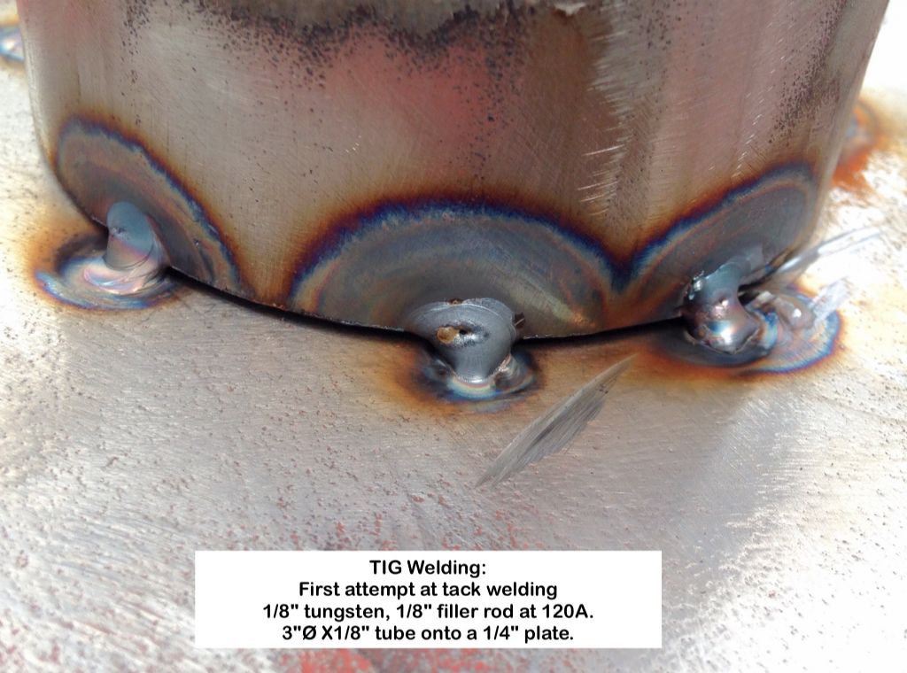

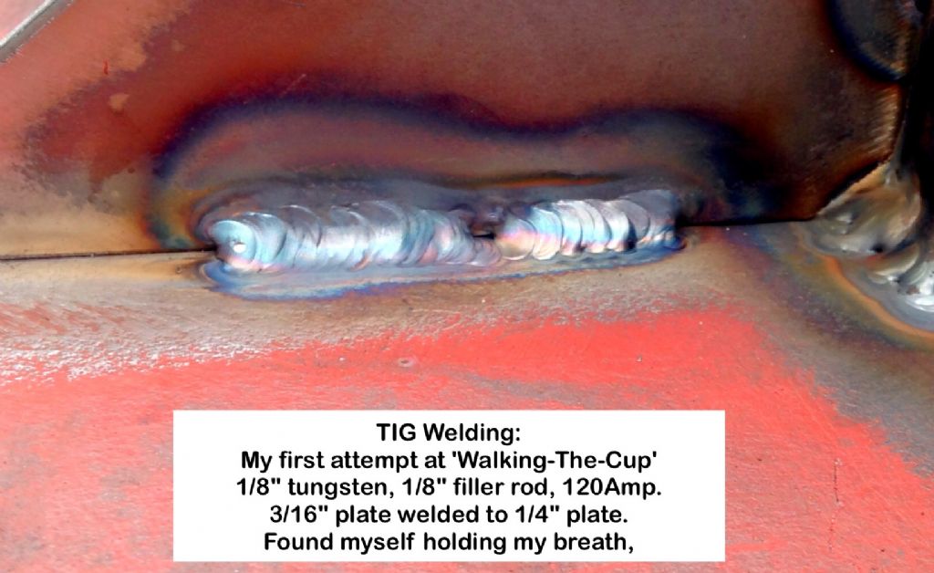

OuBallie25/05/2015 09:51:56
avatar
1181 forum posts
669 photos
Update.
Photos say it all.
TIG Welding
TIG Walking-The-Cup
This is the limit for my machine, set to its maximum amperage, and thankfully I won't be welding 1/4" every day.
This is the vice stand, photo to follow.
I will now only use MMA for quick and dirty welding as I spoke far too soon at my improving.
Well I did improve welding flat joins, but a real dogs breakfast on the type of corner weld I've 'succeeded' with using TIG.
Still need to do a lot more practice, but oh my word, what control you have.
Can see why people rave about using TIG.
Geoff - TIG for me from now on.
