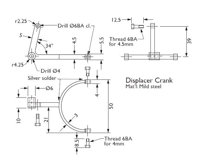

Posted by David Clark 1 on 01/07/2011 08:52:16:
Fig 10
The 2.85mm hole centerline is not shown in line with the 1.75mm recess, it is clearly shown above it. Therefore we either need a height for the hole (PROBABLY 2MM) or the 1.75mm is not the size of the notches on the bearing blocks.
On the original it is clearly shown in line with the 1.75 steps.
Having just seen this engine in the flesh today at Guildford I can confirm thet the holes are above the 1.75mm step.
The engine was running very sweetly so I would suggest to anyone thinking of making this not to be put off by these drawing issues if they can all be resolved it will build into a nice piece to add to your collection
Jason
PS Drawings in 4408 look beter just need the angle for teh displacer crank in Fig 23 its shown as a strange 34+
David Clark 109/07/2011 14:44:16
avatar
3357 forum posts
112 photos
10 articles
Hi There
This is the drawing I aproved for press.
As you can see it clearly says 34 degrees.
It has obviously been changed by the page design software.
I will get this checked on Monday.
Probably to do with the fonts used.
regards David
Edited By David Clark 1 on 09/07/2011 14:44:55
JasonB09/07/2011 15:29:37
avatar
25215 forum posts
3105 photos
1 articles
Yes could well have scanned in 84 and got 34 out.
Thanks, J
blowlamp09/07/2011 15:39:28
avatar
1885 forum posts
111 photos
I get that angle at 77 degrees by tracing over it.
Martin.
JasonB09/07/2011 16:16:40
avatar
25215 forum posts
3105 photos
1 articles
Looks like it could also do with a dimension between the fork holes and the 4mm hole while you are at it David, as yw long teh lower arm should be without a lot of calculation
