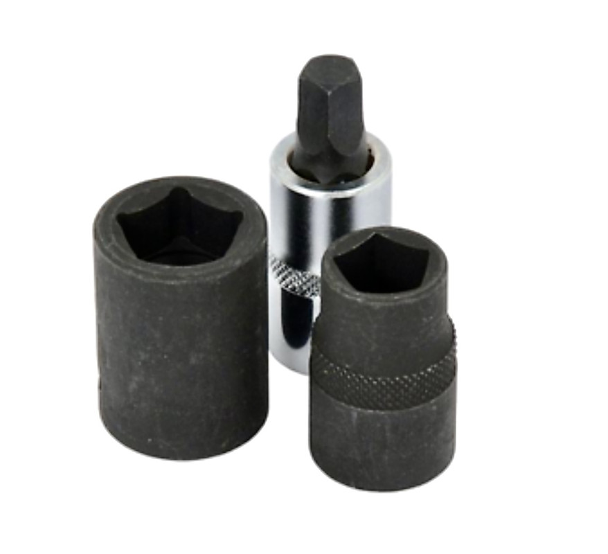

I’ve not read the whole thread so apologies if someone else has mentioned it but apparently some Japanese motor bikes have five sided head bolts.

Torx Plus (IP) not the 5 sided are quite simply the best internal fasteners, they're amazing, there's probably a long list of reason manufacturers haven't switched over to using them as a norm, hex fasteners are decided by manufacturer quality and the quality of sockets used on them too, I've given a few of my sockets a rough measure.
The top photo is a Snap Flank drive FDX 16mm socket, these are made to precise tolerances, and show exactly 16mm.
The second photo is a middle of the road 14mm impact socket that shows 14.2mm
The third photo is a 12mm Taiwanese blue point socket showing 12.2mm.
The fourth photo is a standard snap on flank drive 16mm showing 16.14mm
