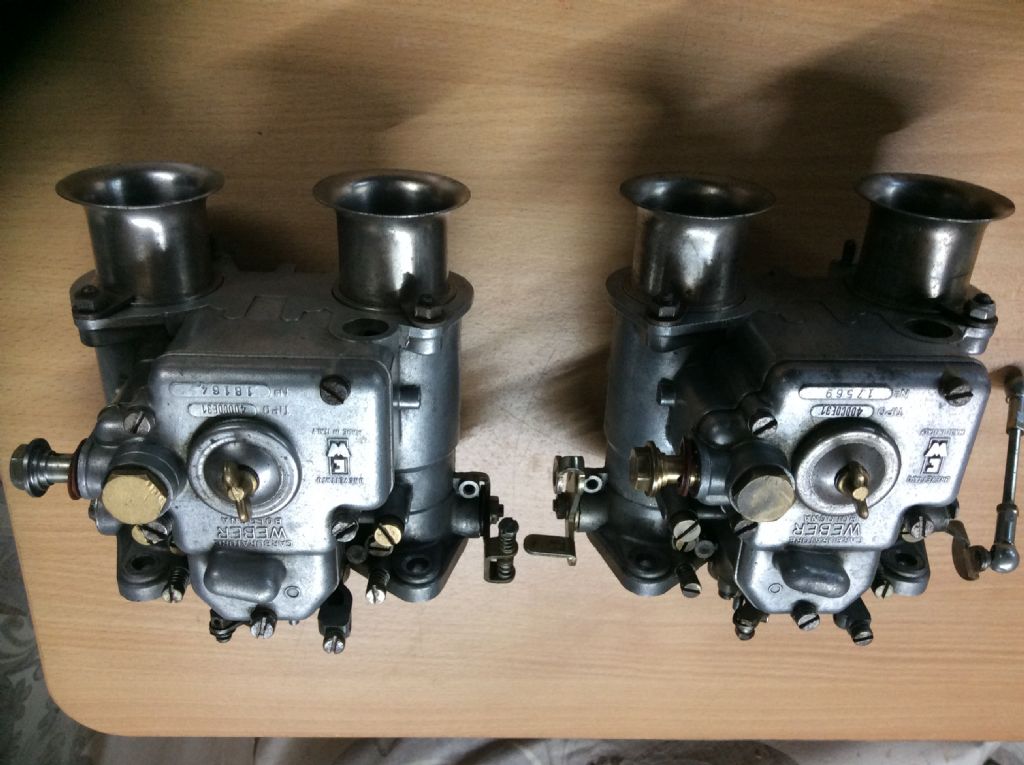

A few years back I visited a 2nd hand shop on nearby town which I do frequently, however that time I looked into a cabinet full of cutlery(Never looked here) and to my surprise saw 2 small vices, one good for my small drillpress(but not a drillpress vice I would say), and other one looks like a machinest vice very solid but small and can do angle. So this week I mounted it to an old X/Y vice I used for many years and scrapped since I got the mill, mounted it to the base of this vice to get it higher for small milling jobs. It does not have an achme thread, but one of those where the one side is striaght and the other side at an angle, not a normal thread either. I tested it, it holds up in milling, it was cheap and I repainted both.

Posted by Chris Mate on 12/11/2022 03:33:02:
AKA a Buttress Thread.

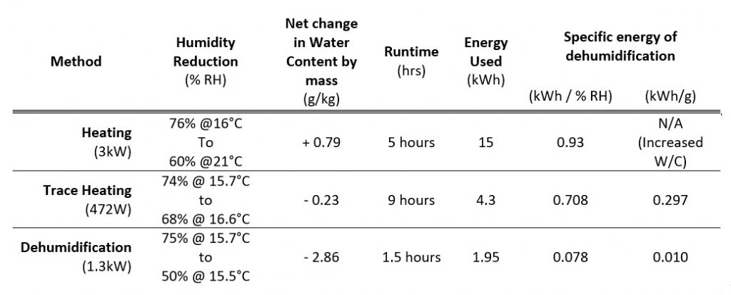

Finally got round to installing my dessicant dehumidifier after it sitting in the workshop a month of not having time.
13-11-22 Dehumidifier
I need to buy some 75mm PVC PN10 pipe and fittings to replace the Jerry rigged connections with 100mm ducting; then sort out programming a PLC up to integrate it with the trace heating to maximize efficiency.
Currently I have just this wired to a cheap smart switch which will act as a humidistat, whilst the trace heating runs off a similar smart switch which acts as a thermostat.
My hope is that this will be a far more energy efficient rust prevention tool than trace heating alone, as it can remove a vast amount of humidity from the air very quickly, and will work equally efficiently regardless of air temperature (unlike refrigerant dehumidifiers)...
Oh and rather irritatingly the closest I could get it to the ceiling results in the bottom of the brackets being at 6'2" in the air...
Just above my eye-line, but still at prime forehead gouging height!
I think some pipe lagging is probably in order to pad that out.

Posted by Jelly on 13/11/2022 16:18:47:
Some brief test data on this from last night compared to data collected on similar nights (in terms of temperature and humidity profiles) with different approaches suggests it's going to work out far superior to trace heating or heating alone.
13-11-22 Dehumidification Test
The next piece of data I need to gather is what the "recovery rate" of humidity is for direct dehumidification, (which is linked to Air Changes per Hour and external humidity, but must effectively be empirically determined) as compared to heating (where the thermal effects predominate, and I have a decent thermal model from when I did the insulation).
I also need to:
  • finish the last bits of the insulation job,
  • replace the outlet grilles for the welding extractor with flap-type grilles to reduce the external airflow which can pass through with wind, and
  • sort the moisture ingress under the bay door cill during heavy rain using some combination of epoxy, concrete, and diversion.
As otherwise I'm actively fighting things which could just be mitigated.
