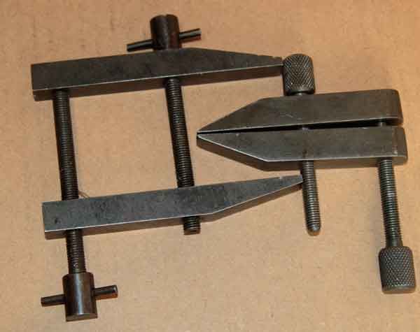

Stuart Bridger30/03/2023 08:27:20
566 forum posts
31 photos
This is a practical example of two different techniques, not recent I add. There is some wear, but it does illustrate the durability, albeit with the limitations of the photo reproduction
The one of the left  I made at school, I think in 1978 and was blued by heating and dipping in in old engine oil.
On the right was an apprentice piece, made in 1980 and phosphated using a commercial process.
Edited By Stuart Bridger on 30/03/2023 08:29:03
Edited By Stuart Bridger on 30/03/2023 08:30:57
