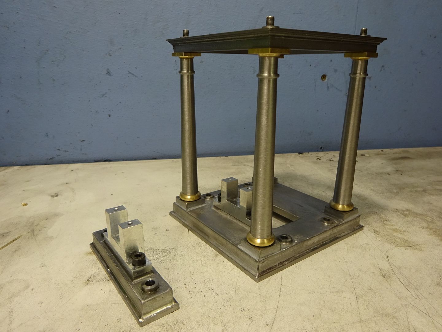

It's a james Coombes but not as you know it!
Having reworked the Stuart Real recently I thought that the James Coombes could do with similar treatment. To my eye this looks better than the two flat 3/16" plates and very plain columns of the original model
