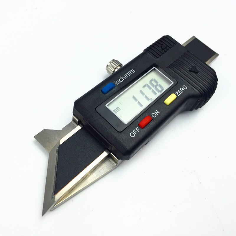

What I'm seeking is a simple tool(s) to measure the radius of convex fillets (i.e. the radius on "break-edges"?) created on 90 degree edges.
Something similar to that Helios Preisser H0597305 would do the job, but 211 Euros is GBP177, and worse post Brexit there will now probably be a hefty import tax on it... ==> over £200?
So I was hoping to buy some very simple L shaped pieces of steel with precision radiuses inside corners, with which to make quick checks.
THOUGHT:
If, as some of you have suggested, I just assume circular radius and just focus on measuring the equivalent 45° chamfer, what about buying something like this?
**LINK** for c. £56
Or a digital equivalent for c. £76?
**LINK**
Or similar... (?)
