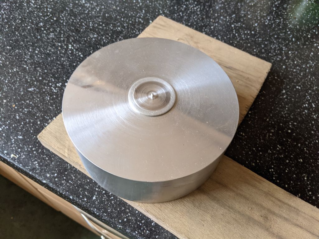

Progress update, today I managed to turn the plug to size. It ended up at around 39.985mm.
So I bored the hole out to 39.905mm, somehow it worked out perfectly.
Then straight off into the oven, and the plug into the freezer. Left them both an hour. Then it slipped right in. Pretty much immediately wouldn't come back out. I left it to cool, then chucked it back up and faced each side. Then on the second face I drilled and bored to 24mm
It's nice how the plug sort of disappeared when I faced it
Thanks to everyone for their help so far.

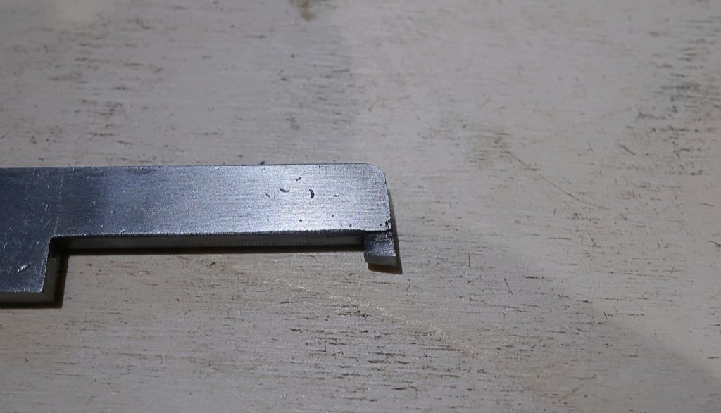

When I did the two 4mm keyways in the steel rollers below, I used gauge plate (Ground Flat Stock) simply because it can be milled & filed to an accurate slot 'cutter' shape before hardening with far greater control of the shape (esp. the corners) than can be achieved with HSS offhand on a bench grinder.. ..made for a crisper slot that didn't need any dressing..
The 'rake' on the front cutting edge was deliberately left steep to prevent 'digging in'..
I gave relief to all sides, only the cutting edge and a short distance above it was at finished dimension, final few licks with a stone after hardening.. ..looks a bit rough, but only the cutting edge on the front corner has to be 'good'..

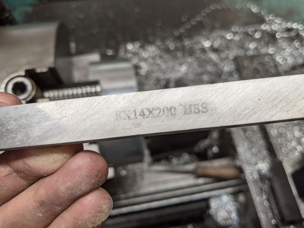

I think I have a boring bar type tool that would be perfect. The only issue I can think of so far is that I can't use by belt sander to shape any cutters so I'll have to get the bench grinder reassembled.
What sort of depth of cut should I look at trying to take?
I'll try to make a tool smaller than 8mm, perhaps 4mm then I can do it in two passes. If diogenesII did 4mm in steel then I imagine 4mm in aluminium will be fine

I think Jason's suggestion of making a 3mm wide tool, cutting two separate slots, and then clearing the central 'upstand' is a good one, and more likely to give you a straight-sided slot at the end of the job.. ..if you try to do two 4mm 'bites', the first will be okay, but the tool will want to wander into the 'open' side on the second pass..
The depths of each cut should be shallow - try 0.02mm / .001" and see how it goes, I found the job went quicker taking shallow cuts and just turning the cross-slide round a division or so with one hand whilst racking the saddle with the other - a human approximation to a shaping machine..
In any case you will be able to feel whether you can take a bit more or need to take a bit less, once you get started.
You might be able to grind the necessary reliefs around the end of a small piece of HSS off-hand on a benchgrinder - only the cutting edge itself really has to be straight (-ish), as long as the rest of the tool 'body' has a little clearance so that it doesn't rub on the sides or base, it doesn't have to be particularly accurate or even in this manual operation - a Dremel might do it..
Taking some care to make sure the cutting corner is 'sharp' pays dividends, it becomes tiresomely hard work with a dull cutter.
