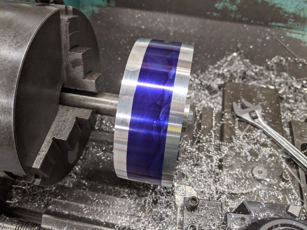

No bodging here, and no youtube either... This may have been quite a challenge for me, but that's why I've found it so enjoyable.
Today's progress should finish the job completely (as far as the wheel is concerned. The belt sander still needs fixing up somehow, but that's a problem for another day and thread)
The day commenced with turning a 24mm mandrel to remount the wheel onto. I make sure it was a very tight fit with no slop. Then I double-checked the runout on the outside to make sure it was the same runout that I'd seen on the motor shaft. This meant that it was accurate enough and taking a cut was likely to result in a better concentricity, so I decided to take the plunge and skim the outside.
After skimming the outside I decided to put a tapered crown on the wheel to *hopefully* help the belt sander track a bit better. This went quite well, just like when I did the same thing to the tracking wheel.
Next step was to create the "dutch keys" for the 'braces' half. I put some layout fluid on the surface where I thought the holes needed to be, then I marked the holes and drilled to 4.2mm, ready to tap to M5.
Once tapped and deburred, I dropped a blob of locktite 271 onto each of the M5 grub screws then tightened them down.
Howard, I understand you were saying to use long grubscrews or as long as the thickness of the wheel. I just used what I had lying around already, It's better than nothing. I just hope they're not needed at any point. The shrink-fit will hopefully do enough and the belt sander won't have a hard life anyway.
With that completed, the wheel was remounted onto the motor. All finished.
I checked the outside for the concentricity and it looked to be about 1.5 thou out. This may not be perfection, but it is significantly better than before. Plus, the vibration is practically gone, which is exactly what I wanted. No shims are required either...
Thanks to everyone for their help, I'm very grateful for your knowledge.

23/08/2021 20:23:44

Progress update, today I managed to turn the plug to size. It ended up at around 39.985mm.
So I bored the hole out to 39.905mm, somehow it worked out perfectly.
Then straight off into the oven, and the plug into the freezer. Left them both an hour. Then it slipped right in. Pretty much immediately wouldn't come back out. I left it to cool, then chucked it back up and faced each side. Then on the second face I drilled and bored to 24mm
It's nice how the plug sort of disappeared when I faced it

17/08/2021 09:42:06
Posted by Cabinet Enforcer on 17/08/2021 09:00:07:
The domestic oven is a fine device for gently and controllably heating a part for shrink fitting purposes, and is usually conveniently located near the freezer nerd Just remember to clean any oil off first.
Nice belt sander, is it Jeremy Schmidt's design?
Ah yeah that's a good idea too. It's made me think, I have a small electric oven in the workshop which I usually use to temper metal. That should get hot enough and have enough space for the wheel.
Thank you, no it's not Jeremy Schmidt's design, its my own design of an amalgamation of my favorite features of ones I've seen. Plus a few different choices to make it easier for me to make with the tools I have available. I have the Solidworks design if anyone wants it, but it's relatively specific to the motor I had already, and uses the metal sizes my local metal place has.
16/08/2021 17:53:02
Okay right so I'll bore everything and forget about the reamer.
Yes, I suppose they should expand and contract together so that should be alright. I've never noticed the back wheel getting massively hot, but I don't tend to touch it much!
The only issue I can think of will be the difficulty of heating the wheel and cooling the plug at the same time, since I don't have a freezer in the workshop. I'll have to heat up the wheel, pop in the house and grab the plug from the freezer, then heat the wheel back up again, then press it in.
Another issue will be recutting the keyway! I'll worry about that later...
