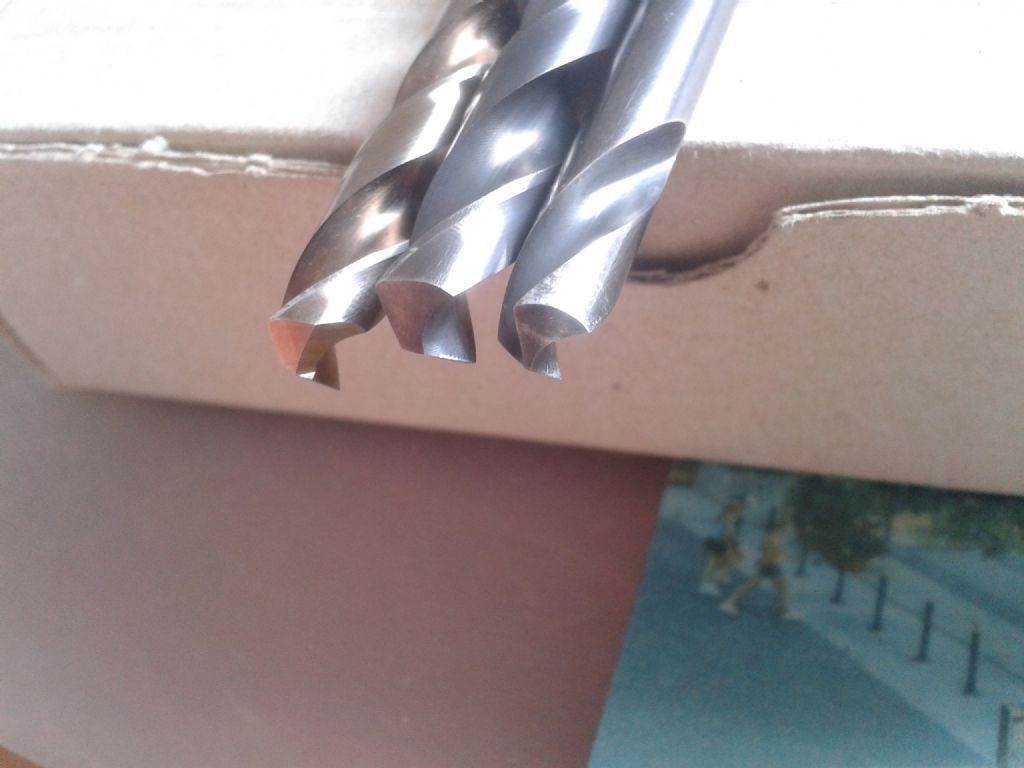

Well using centre drills for starting drilled holes may be considered incorrect but it is what I do most of the time unless of course the hole doesnt need much accuracy. I cant see a problem with it, it works well enough, for me anyway.

You can use straight shank stub drills (used mostly for sheet metal) to start the hole. They will not wander off. You cannot drill very deep with them as the flutes are short and they have no side margin, good for about 3x the dia. but that's enough to get you started.
The drill on the right.

I use centre drills for making centres, and for starting drills, on the lathe. embarrassed
But I never use them on the vertical mill. For general work 4-facet drills start fine, on a flat surface, without the need for spotting or centre pops. If I need better location accuracy, less than 2 thou, I'll spot drill first. The trouble with centre drills is that it's only too easy to break the tip on a vertical mill. And they're not much use for small drills as the tip is bigger than the drill.
Centre pops are only used when I'm drilling by hand (mostly sheet metal) or for rough 'n' ready holes using the drill press.
I expect that in industry spot drills are not held in drill chucks, but collet chucks or similar where the length can be accomodated.

I use spotting drills on the mill and centre drills on the lathe, where the 60 degree matches live and dead centres. I also have some centre drills with a 90 rather than 60 degree angle, I'm not sure what they are intended for, but I use them for subsequent drilling.
It pays to use a new drill bit if the hole is critical, a good make if possible.

Just a thought, I would recommend grinding a negative relief on the cutting edges of the drill. This will make the drill cut bronze nicely. A standard twist drill straight out of the packet will tend to grab at the bronze and pull itself into the job, in any which direction it chooses. Also point thinning the chisel edge on the point will tend to make the drill keep to centre. Drill grinding is a simple thing to do.
