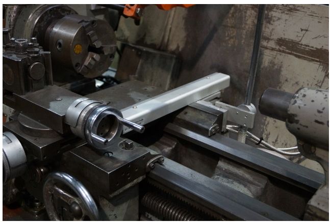

![]() 5068 forum posts 3 photos | Not really about keeping up with design but though I'd keep it all in this thread about the Bantam so it's searchable.
Next job is to fit a DRO. This is also applicable to a Chipmaster as they share the same saddle and it's not a good design to fit a DRO to. This is what you are faced with.
There is a groove machined into the saddle either side but it's not wide enough to take the scale. Add to this these lathes have the slot for the compound bolts in the side of the cross side so you cannot cover these up. Result is the whole lot has to stick out the back and into the air. Asked around for pictures as to people who have done this and everyone has had the same problem.
This is a typical one.
Which puts the scale right out the back, sticking up above the cross slide by 1/2" and needs a further 1" at the rear. In all fairness this is about the best you will get fitting even the slim profile glass scales. Possibly do better with a Newall system but these are not budget systems.
So staring at this and wondering how I can do better I decided to remove the carriage to have a better look. It was slated for removal as it's only equipped with one ball oiler per side and a tiny one at that, plus when up ended there are no oil grooves in the flat face. Whilst on the subject the cross slide has no oilers fitted at all ?
Those two grooves ? Well they are purely clearance and no reason at all why they have to be that size. So any purists now need to get their Horlics and go off to bed or if you are reading this in the morning I'm sure your Audi need polishing - again. So onto the mill with the saddle and with a nice sharp cutter open the groove up by 1/2".
While we are at it, poke the tiny oilers out, drill thru for some of Mr ARC's finest 8mm ball oilers and gouge an oil groove in the flat section, the V is taken care of by the vee on the bed being flat topped.
That takes care of the saddle.
Hunt a bit of 5" x 5" alloy plate out and using precision felt tip marks, pocket the insides out.
The two screw holes line up with two existing holes on the back end of the cross slide so when it's bolted to the slide it forms a nice neat extension.
Scale offered up and it all fits where it touches so job must be a good un?
Bracket underneath to take the read head and a bracket on the headstock to take the display arm and display.
Quick test and it's half past dark so that will do me for tonight. Just need the long scale fitting which isn't too bad other than the flat machined surface on the rear is at an angle to the bed so needs some bent plates to carry the read head but that for later. |

![]() 2904 forum posts 448 photos | Looks like a neat and robust solution as you might expect! Can't make it out from the photo but is the read head thing hanging down underneath the scale, out the back? What are the height and width of your scales? Never taken my saddle off. I assume you remove the RH leadscrew support, remove the leadscrews, drop the apron (is it simple?) and then remove the saddle retainers. I expect those bolt holes on the cross slide were for the taper turning attachment but hardly a big loss if they were, for me at any rate. Murray |
John Stevenson | 28/06/2015 13:14:32 |
![]() 5068 forum posts 3 photos | Collective answers and questions.
Mike, Never thought about magnetic strips, how do these cope with flood coolant ? Plus I already had this DRO setup. Neil, 2 M4 cap heads supplied with the scale, didn't realise you could TiG weld alloy to cast ?
Murray, I'll get some pics from the back later today and post them. Yes the read head is at the rear and again mounts to two existing 1/4" Whit tapped holes in the carriage. I used a slice sawn off a generic scale bracket left over from fitting another kit.
Saddle comes off easy and just as you say. Bracket off, the two dowels are tapped 2BA for an extractor, screws out, they just pull thru. Apron is secured by 4 cap screws, two front, two rear in the 'top wings ' of the apron and it drops clear. Then the saddle slides off the back and you can upend it to remove the retainers if needed.

John Stevenson | 29/06/2015 01:14:58 |
![]() 5068 forum posts 3 photos | Ran a 1/4" whit tap thru most of mine to clear the crud out.

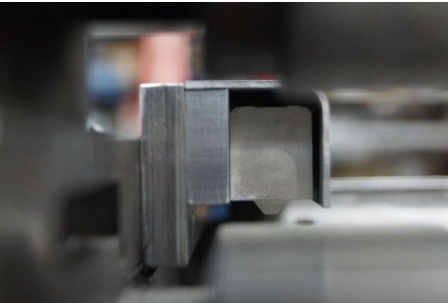

OK pic of the cross slide read head.
Also shows underneath the sub exyension and also not to self that the transit clips, yellow, are still fitted to the scale.
Then I got side tracked and started to fit the long scale. Bolted this to where the taper turning attachment should fit as it already machined flat. For anyone following in these footsteps later the face is at 15 degrees to the vertical
This is one of the generic brackets supplied with the long scales, not that clear but the bottom leg has been shortened and milled away at 15 degrees. Next job is a flat link plate between theis bracket and the long read head.
More to follow at a respectable hour. |

![]() 814 forum posts 36 photos | My solution to a similar problem on a small Myford Speed 10 lathe was to fit a magnetic scale underneath the cross slide (photos in my album ) with the read head mounted at the back. This way there is nothing that gets in the way along the side of the cross slide. I did this a while ago and so far it has proved to be very reliable and convenient. If this can be done on a very small lathe with very little space to play with ,it would be a doddle on a larger lathe. Doug |

![]() 814 forum posts 36 photos | I don't think coolant would be a problem John. The read head is completely sealed as I remember and I covered the magnetic strip with a thin non magnetic layer of brass shimstock. The only problem I can see is a metal chip getting trapped between the read head and the magnetic strip, but this has never happened to me and is quite unlikely due to the fact that these items are pretty well protected due to their location. There is never one perfect solution, just choices to be made. Doug |
