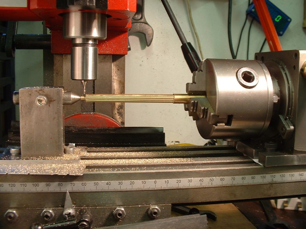

NBice work Jason, a bit more ambitious than my fluted pillars...

What, preparing early for this year's candlestick challenge?
