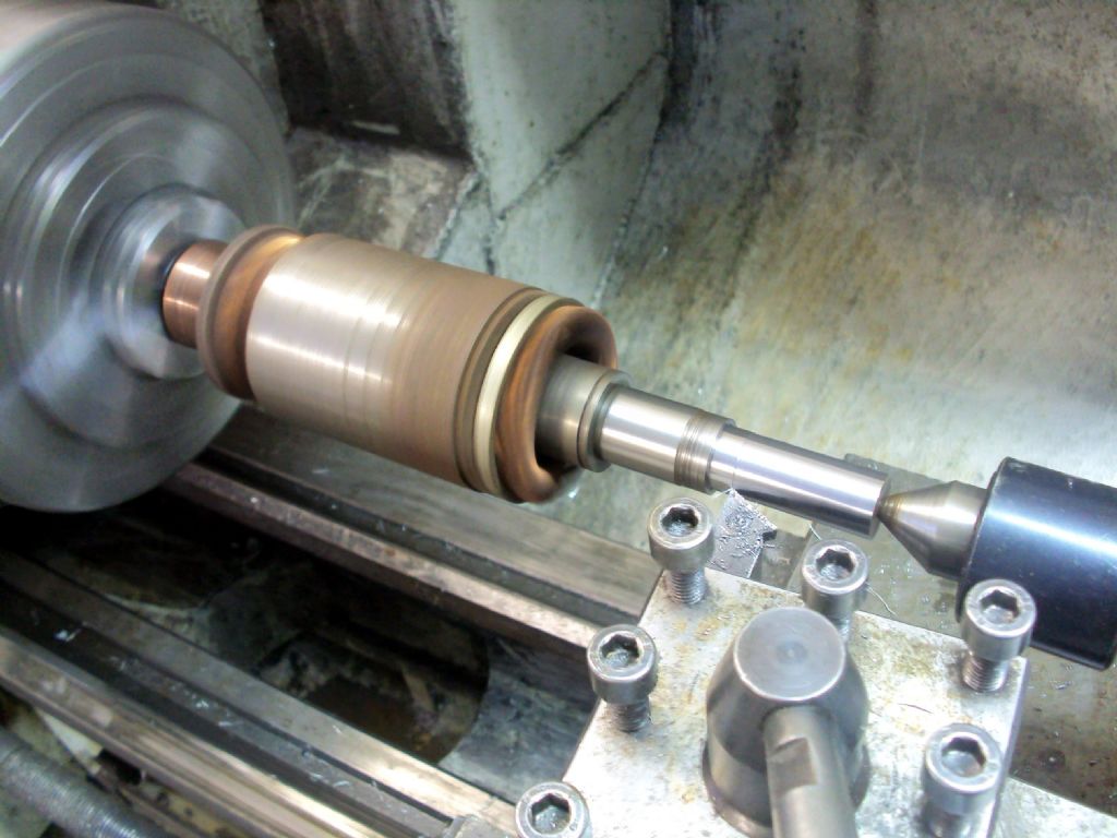

dean clarke 211/02/2016 08:28:56
avatar
169 forum posts
330 photos
Well it has been a little while since an update, but I have not been completely idle.I have been working away on turning the starter acquired on trademe into a usable model engine starter, photos below show the progress to date
That's all for now
Dean

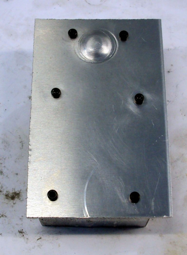

Well here's the latest development for the belt drive cover.........
Milling out the inside of the backplate.........
End of the roughing out stage 1, cover plate next then bolt them together to finish off the profiling.
Cheers for now
Dean
