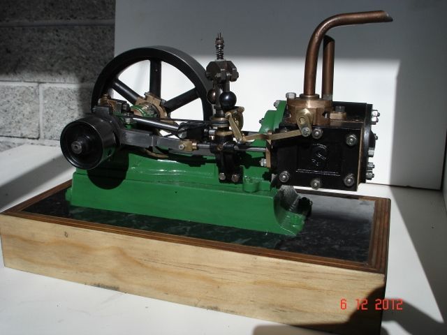

018 (640x480).jpgI rebuilt a S9 last year, it had been started, but was in a sorry state.snapshot_20121005.jpg

One of the studs on the front cylinder cover on mine was stripped, I tapped it 10 32 / 3/16" UNF, and made a stepped stud, think the studs are 4 BA. Another stud in the steam chest had to be moved, I drilled and tapped that and screwed in a slug of cast iron.
Ian S C

Nick,, please complete, I am doing a no 9 now, made a pigs ear of the end caps, so got a lump of cast iron off ebay , much cheaper than stuarts, and re-did them ok now, but not sure about drilling the exhaust port, into stean chest,, can you help me there,, can supply to you a copy of the building plans.

Terry Welcome to the forum, I have just posted one of your three attempts to post
The exhaust port is the largest one in the middle of the set of 3 on the valve face, this is drilled to one side of the cylinder block not into the bore. The other two slots are the inlets which are drilled at an angle to the top & bottom of the cylinder bore. The actual steam inlet is in the top side of teh valve chest
