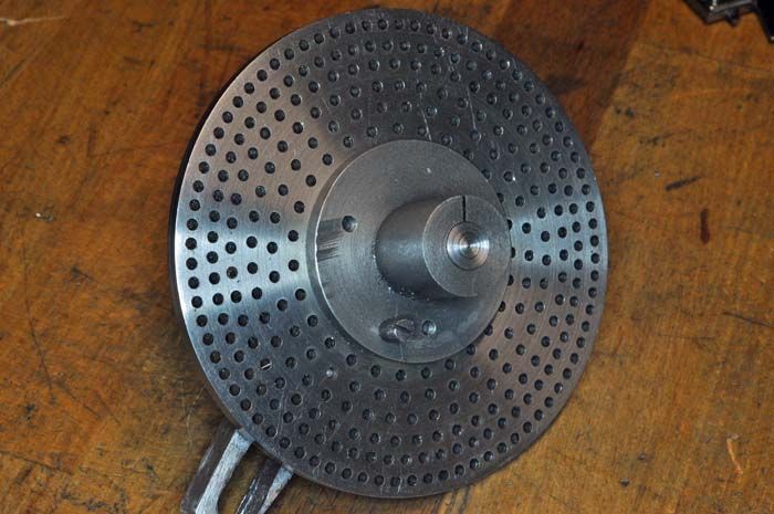

One thing you could try is to make your own collet to fit in the 3 jaw chuck. Something like this:
Ignore the dividing plate. The collet has a peg that snugs up against one of the jaws (always use the same one) and I always tightened the 3 jaw up with the same pinion hole. You can bore the collet to suit, incorporating your depth stop then remove from the chuck to saw the slits ( there is one you can't see from the picture that goes across the diameter flush with the flange. I made both of these with a junior hacksaw, there is room to remove the blade and pass it through the hole before re-attaching to the saw frame). I guess it depends on your 3 jaw chuck but the errors are usually reproducible at the same place on the scroll. It worked for me when doing some helical gear cutting.
HTH
Rod
