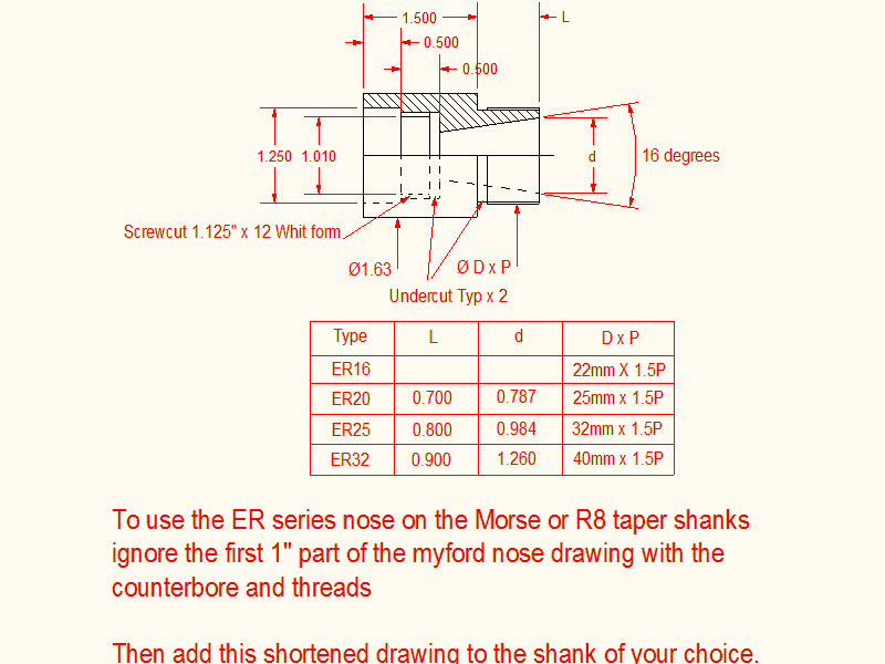

_Paul_12/07/2014 08:01:32
avatar
543 forum posts
31 photos
This diagram (courtesy of Sir John Stevenson) is for a Myford ER32 Chuck it gives you an idea of whats involved to make one.
By turning the chuck on the machine that you will be using it on should ensure that you will get the best concentricity your machine is capable of.
They are not difficult to make but try to select some decent steel to make it from and probably the trickiest part is getting the taper right.
Collet nuts as previously mentioned the ball bearing types have a greater clamping force and are quite reasonably priced at Arceurotrade that said it takes quite a bit of force for a standard nut to let the work slip.
You will find a lot of info and help on the Homeshopmachinist forums heres a starter ER40 Chuck

Matt C Beech13/07/2014 07:03:12
avatar
50 forum posts
24 photos
Hi everyone. Thanks so much for your tips.
I was looking around to see where the beat place to procure one was, bit few places sell them and none have any on stock (unless anyone knows better)
What do you folks use? MT2 taper? What works beat?
John, I think I may give making my own a go, I'd be really interested in the tips on the taper or any other tips you have.

Russell Eberhardt13/07/2014 14:08:28
avatar
2785 forum posts
87 photos
Posted by Matt C Beech on 13/07/2014 07:03:12:
I use a homemade ER32 chuck screwed directly onto the nose. Turning the taper in situ ensures virtually no runout.
I wouldn't use one on a morse taper in the lathe as you are restricted to short lengths of stock. Backplate mounting ones are OK but why have the extra interface? - more opportunity for errors?
