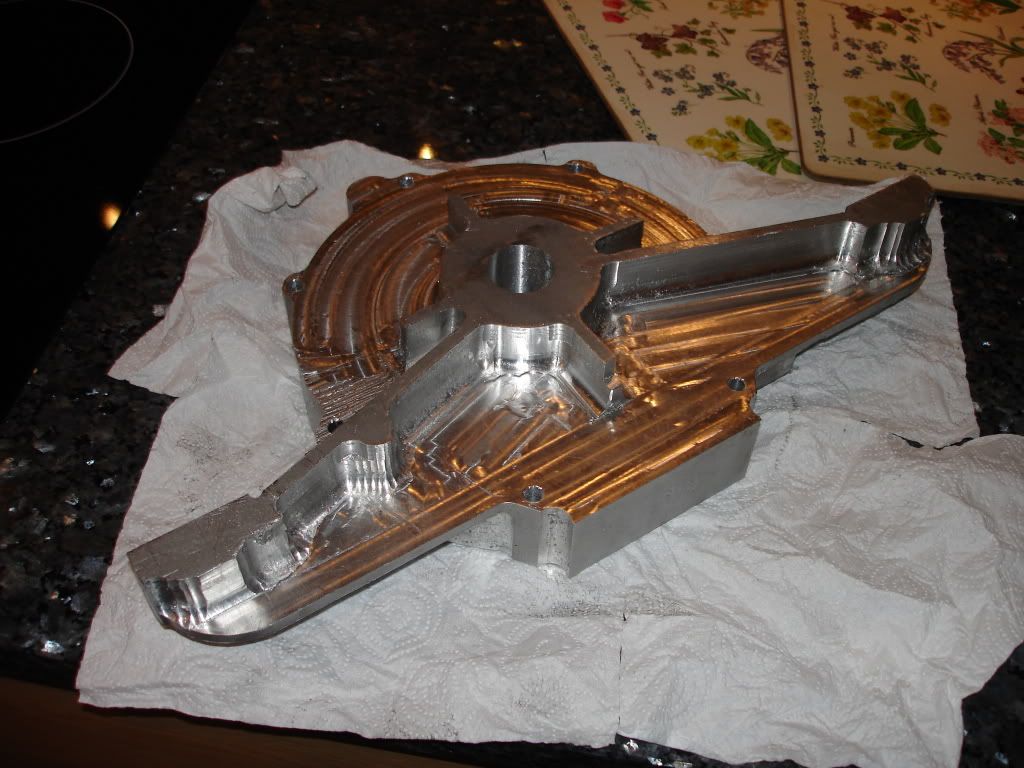

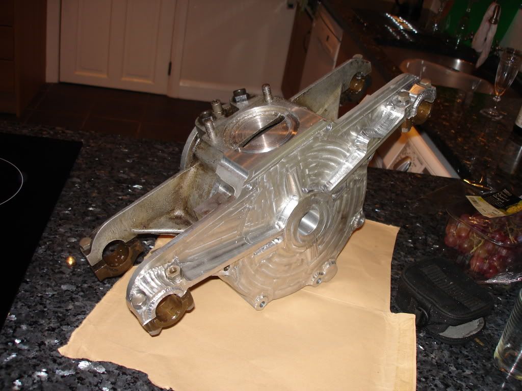

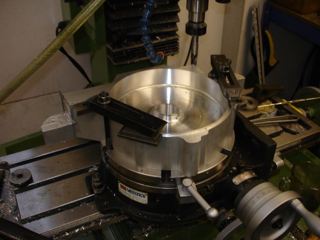

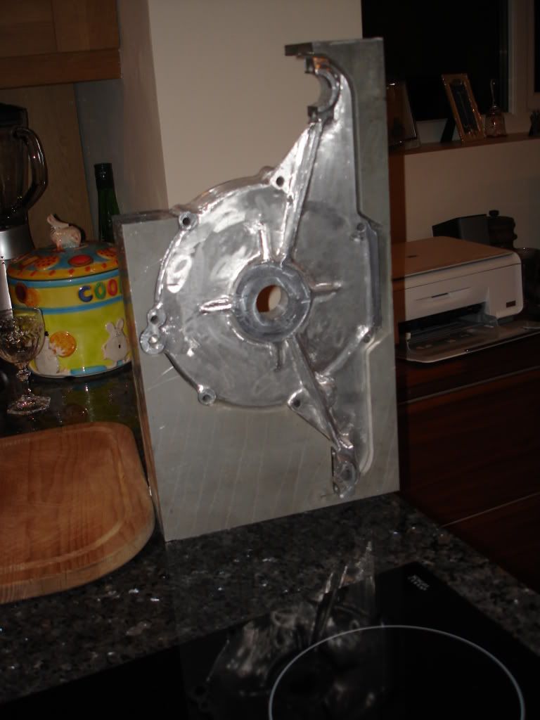

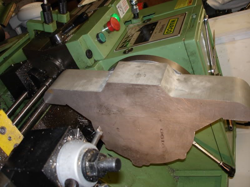

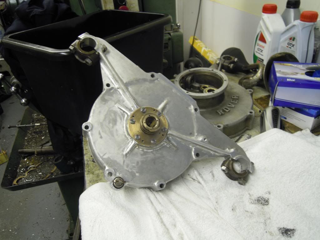

Bob Rodgerson29/03/2014 17:21:21
612 forum posts
174 photos

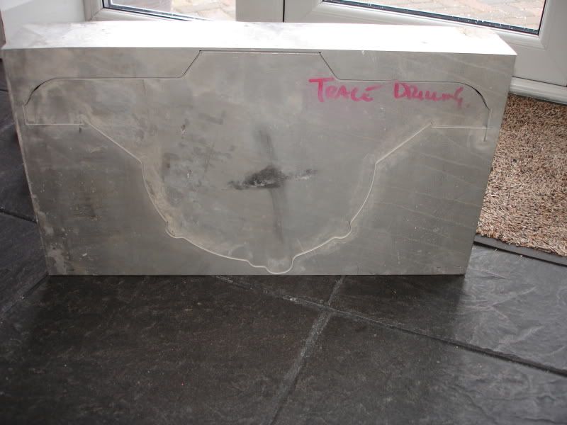

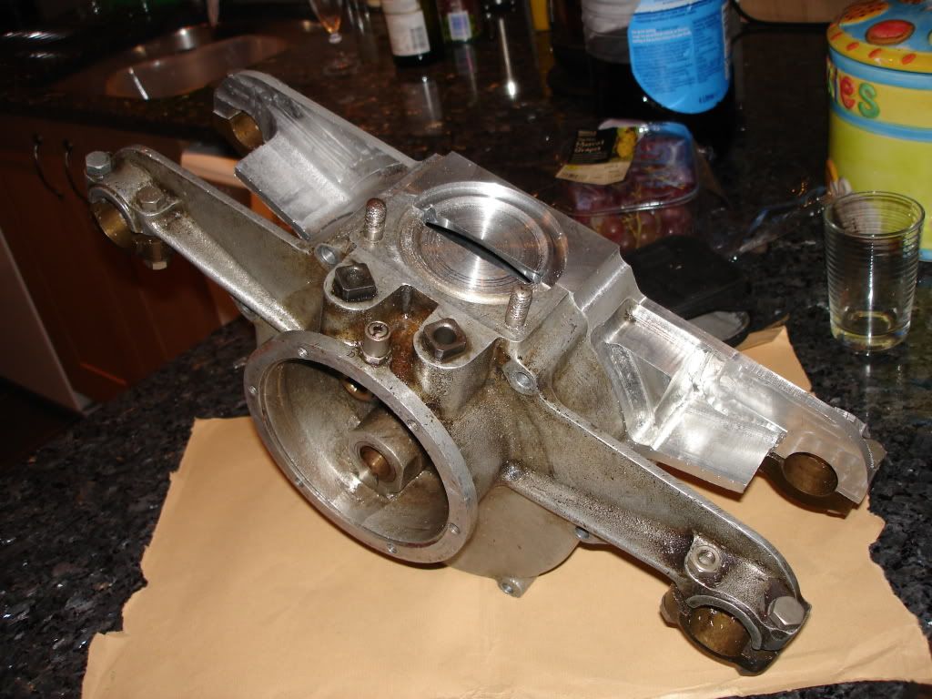

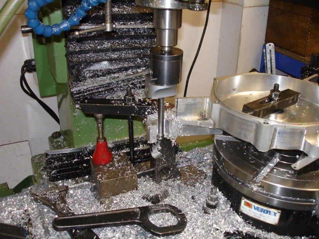

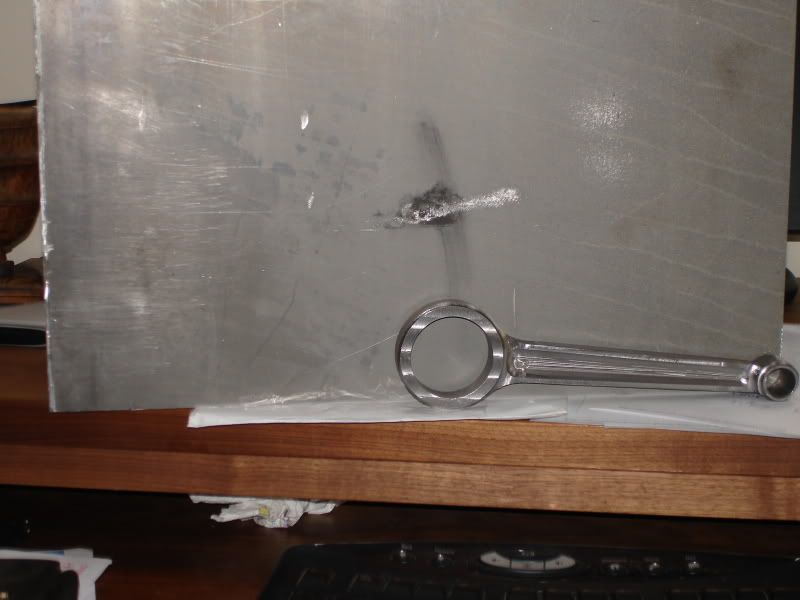

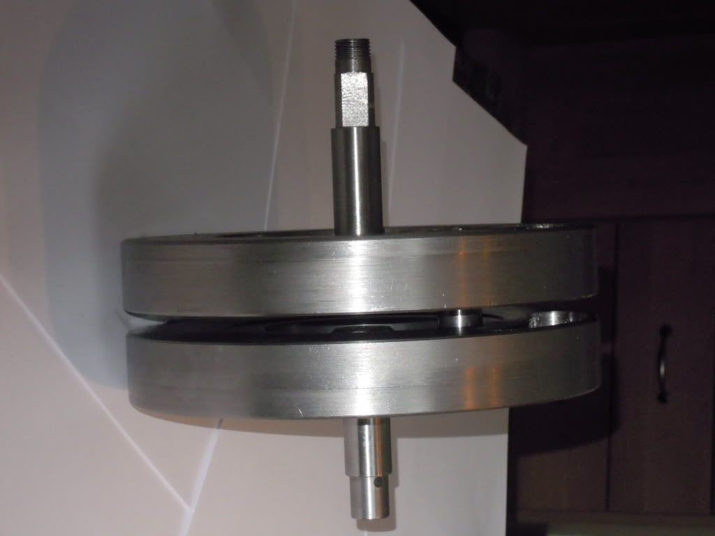

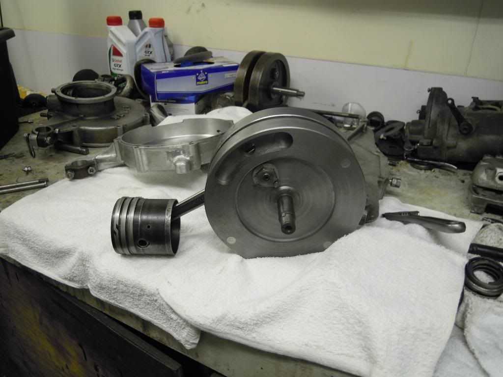

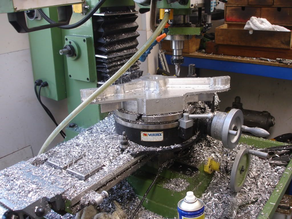

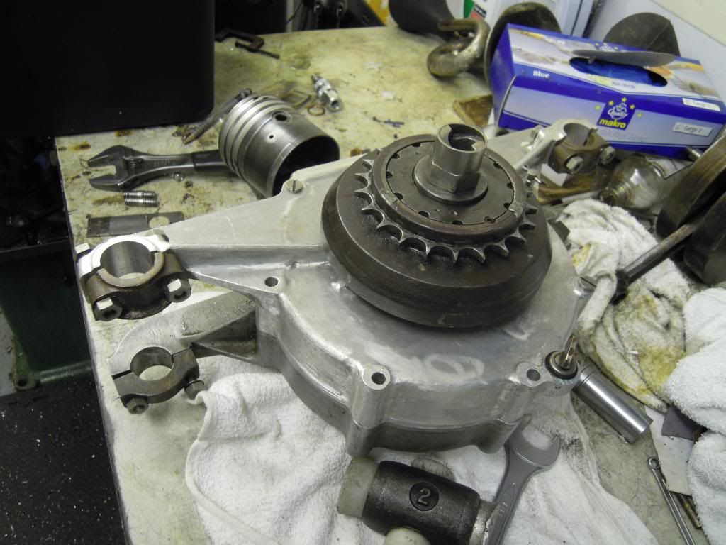

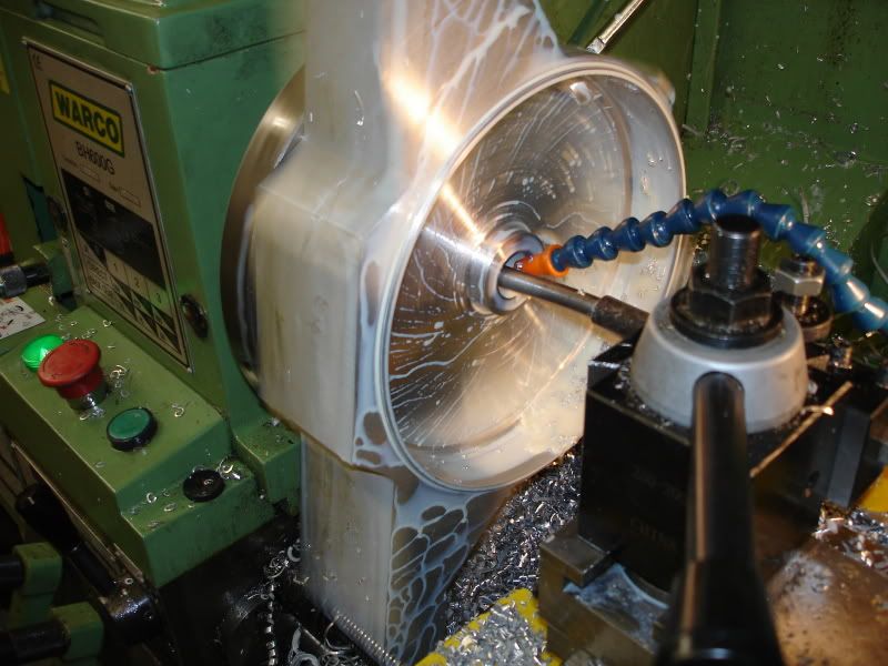

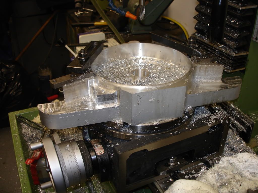

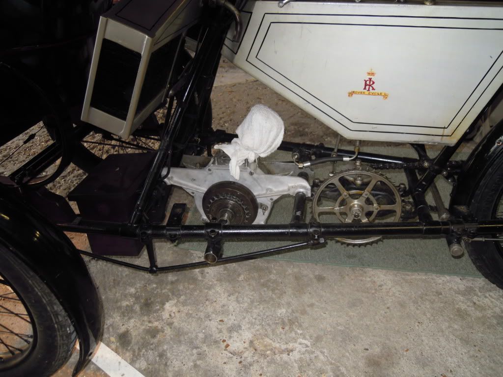

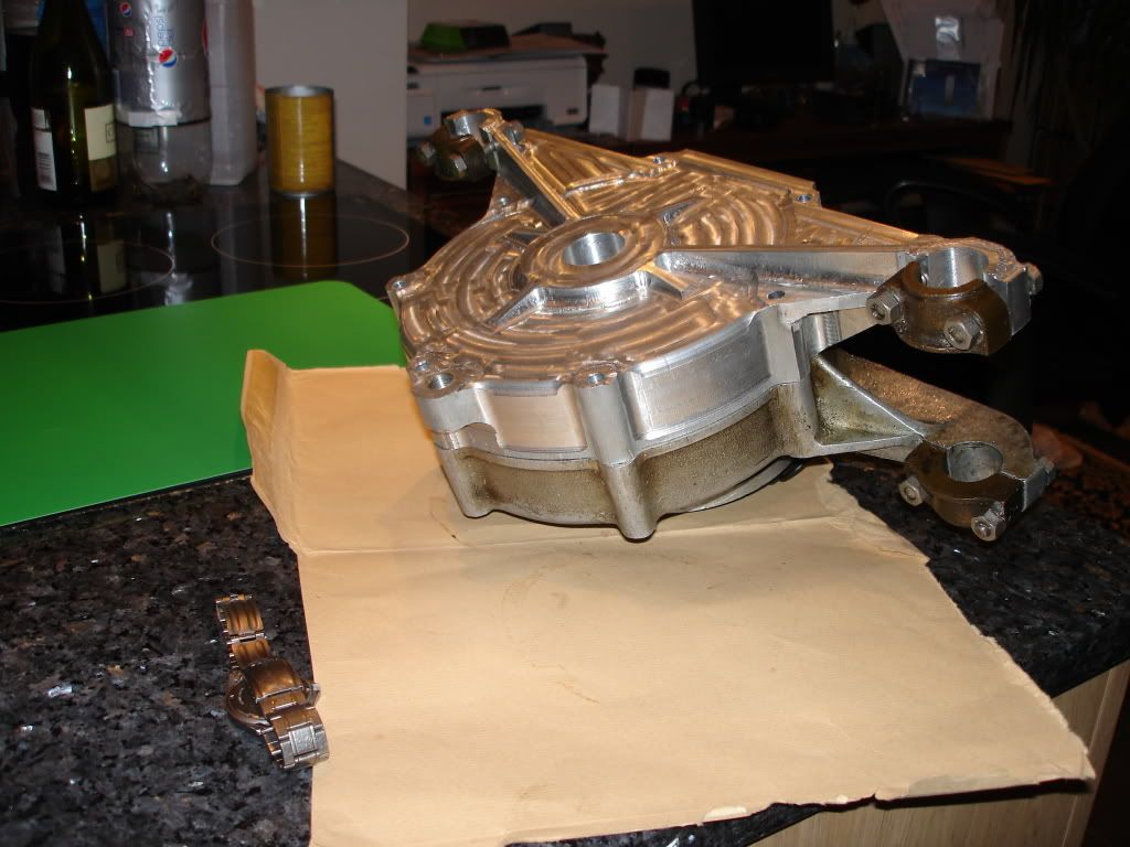

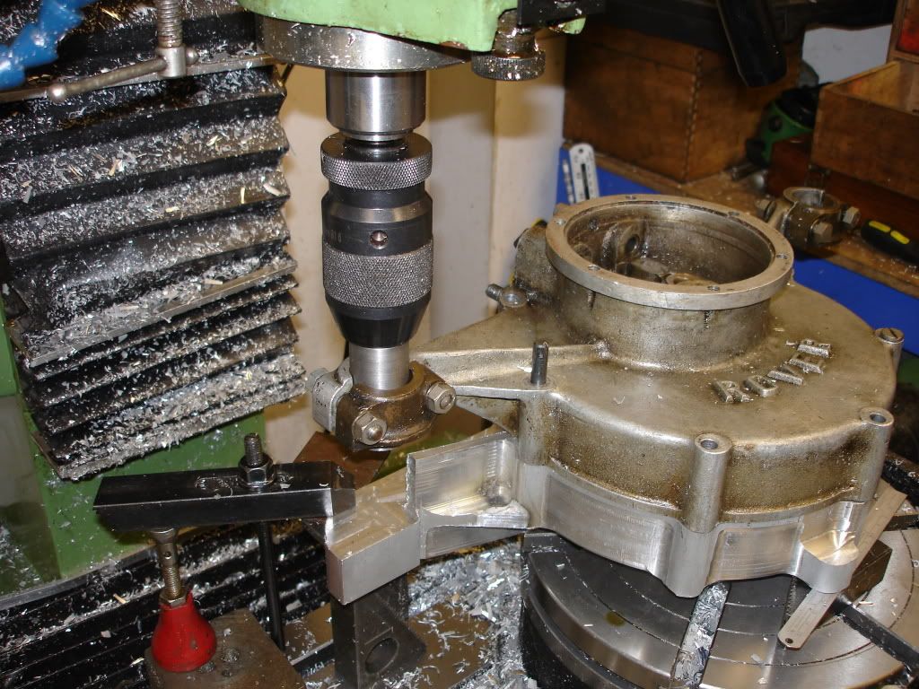

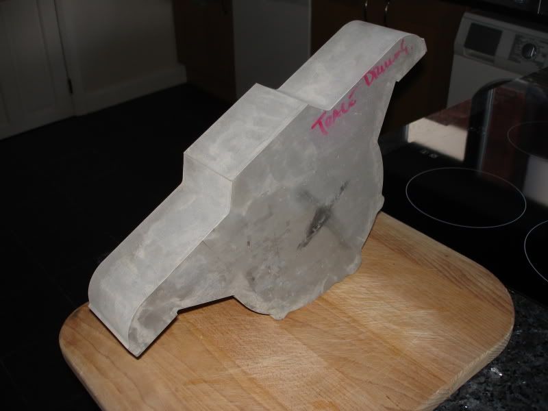

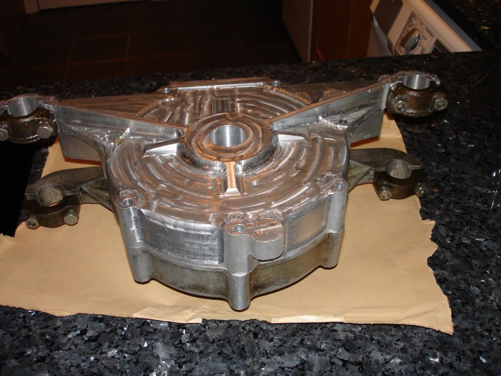

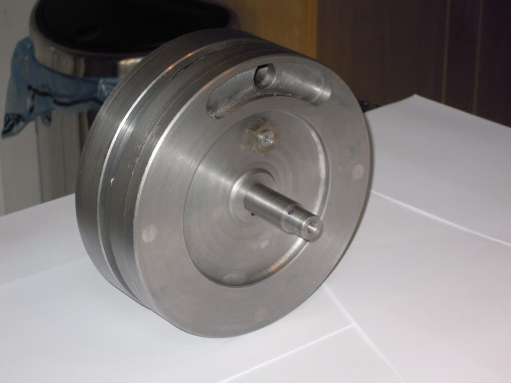

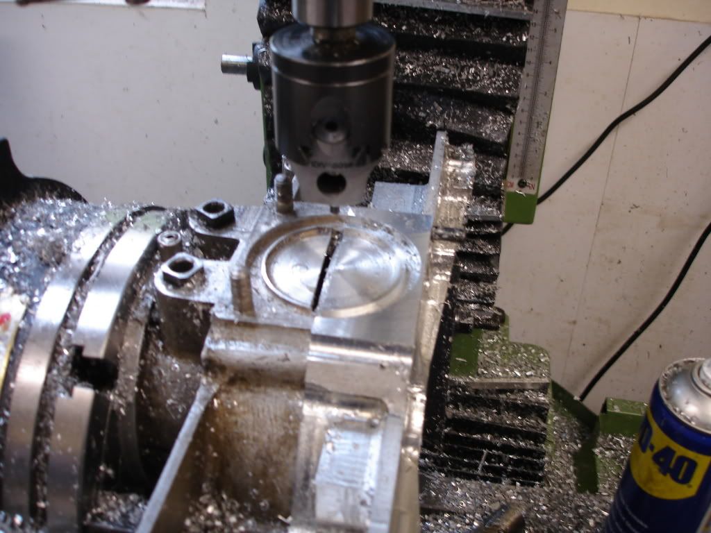

Here are some pictures of a 1905 Rover crank case and crank I made from the solid.

Thor 🇳🇴29/03/2014 17:46:22
avatar
1766 forum posts
46 photos
Hi Bob,
did you want to put a ***LINK*** to your photos? The link should load your first photo I think. Nice work by the way.

Neil Wyatt29/03/2014 19:44:44
avatar
19226 forum posts
749 photos
86 articles
Bob,
I see the photos here. Quite an achievement, very impressive indeed.

Wasn't that the subject of some recent articles in HSM? I recognise the photographs!
