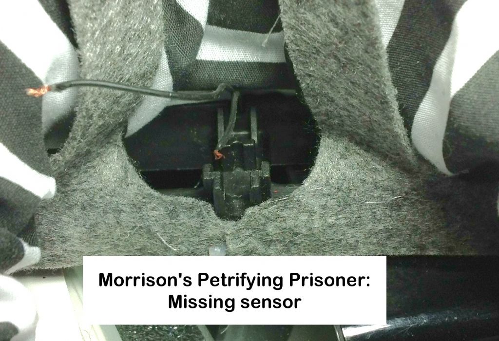

Some advise sought please.
Other half bought one of Morrison's Halloween Petrifying Prisoner toys at half price yesterday.
Unfortunately someone had removed/half inched the small front facing activation sensor, with just two bare wires where it should be.
Does anyone have any idea what that sensor is and can I get something similar.
The 'toy' works via the 'Test Me' button.
I will be in credit if I can get it to work via a sensor.
Power is by means of three AA batteries, but haven't checked if connected in //le or series.

Hi Geoff,
What does said prisoner respond to? Light, movement or... if he's cheap and cheerful, it's probably a phototransistor or photodiode.

Can you measure voltage on wires.
Perhaps you can see if putting a resistor across the wires makes it work.

Neil,
Cheap and cheerfull it most certainly is, and other half said a bunch of ladies nearly had pups when one of them activated the thing by moving her hand in front of it, and it burst into life with flashing eyes and voice. SHMBO joined in the laughter as well.
There is a 4mm wide slot in a front facing moulding that houses the sensor.
I never bothered to inspect them when they where first put on the shelf for sale, so cannot describe the sensor.

Most likely to be an infra red sensor similar to those used in the detectors in outside intruder lights.

I think it will be a photo diode and a simple bridge/comparator circuit with two different time constants. Any sudden jump in the voltage across the diode (caused by a shadow) will set off the alarm. it may be more sophisticated with a microprocessor these days, of course, but any circuit like this will be self compensating, so any photodiode wired to be reverse biased should work to some extent (if I'm right!).

Geoff, if shorting the wires together then separating them sets it off, it's probably a photodiode.

Petrifying Prisoner
Neil,
Correct diagnosis, that is what happens. The slot looks to be the right size at 4mm.

Update.
Have tried three photodiodes:
Two with a dark 'lens' one being IR Filtered but they only work when a bright light is aimed at them
The third has a clear lens that works when light is interrupted.
It appears to need a proximity/movement sensor of some sort.
Ready to file this in the Lost Cause folder and just let her indoors operate it manually, BUT I will be in credit with her if I can get it to work properly

Hi Geoff,
If you have any LDRs (Light dependent resistors.) you could try one of them. They tend to be more sensitive than photo diodes. Maplin no longer seem to stock them so I do not know where you could buy one without sending away for it.

Geoff - I have some big LDR's somewhere I acquired from street lamps as a kid, let me dig out what I have in the scrap box and I'll post the resistance readings, see if one of those will do the trick.

Only managed to find one - but it is big, around 25mm. it's pretty much open circuit in the dark (>50Mohm) and 500K in bright artificial light. Sounds like the wrong characteristic to me.
