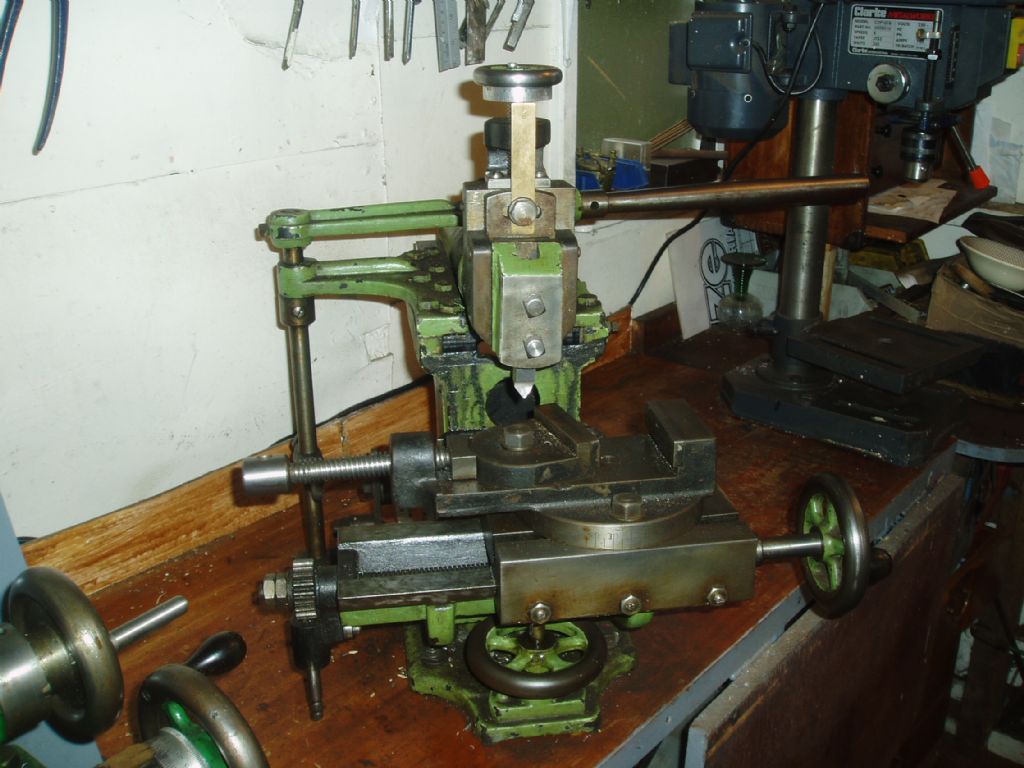

Hi Michael & Guys
I have a small Drummond hand shaper it great to use.
Good luck finding or making one
Nobby
drummond shaper

Nice looking machine, Nobby
But it appears to be bigger and heftier than I need.
Just as a "sanity check" for me ... what is the "Working Envelope" of that one?
Thanks
