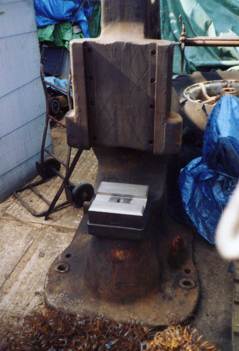

If anyone's intertested, here are some pictures of the sort of thing I used to make for the forging hammers,
This part is an anvil block for a Samuel Platt " Hercules " 160 lb forging hammer,
It started as a 10" square cube of EN8 steel, The dovetails I have formed with the shaper are where the hardened steel die block fits in and is held in place by a fitted key , or wedge,
The dovetails taper 1/16" over their length, usually wider on the right hand side.
The lathe Is a Churchill Redman, 10ft between centres, that I used to have,
The EN8 block was left unhardened, but the die blocks that fitted into it were hardened hot working die steel, 5% Chrome.
The last two pictures show how It all fits together, on a similar hammer, made 1946.
Richard.
