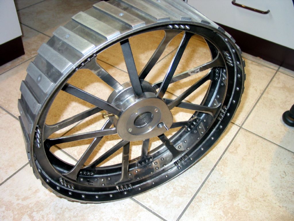

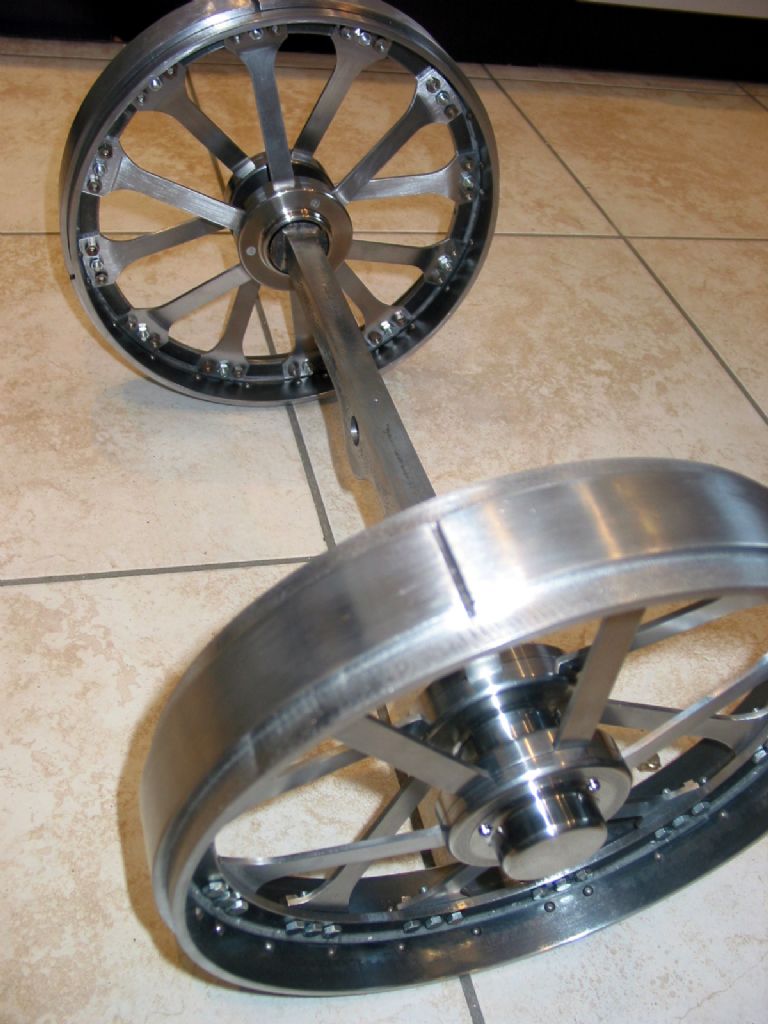

Like yourself I decided I wanted to build a Traction Engine, the only problem was I had very little experience in metalwork but had just purchased a Myford S7. I then spoke to a lot of people on what I should build and they all said "build as big as you possibly can", so I decided to go for a 3" Fowler A7 from MJ Engineering who can supply Drawings and a build manual.
The good thing about our hobby is there are a lot of nice people like Jason out there who are prepared to answer questions and give advice.
Since I start about 18 months ago I have purchased a Warco Mill and a ten ton press and things are progressing quite well
Fred
PS I have attached a couple of Pics to show my progress.

Yes that M300 looked nice but you don't need to own a big lathe to make a big engine. Remember most of the parts are smaller and within the scope of your myford and you can go to an evening class to machine the half a dozen big bits.
