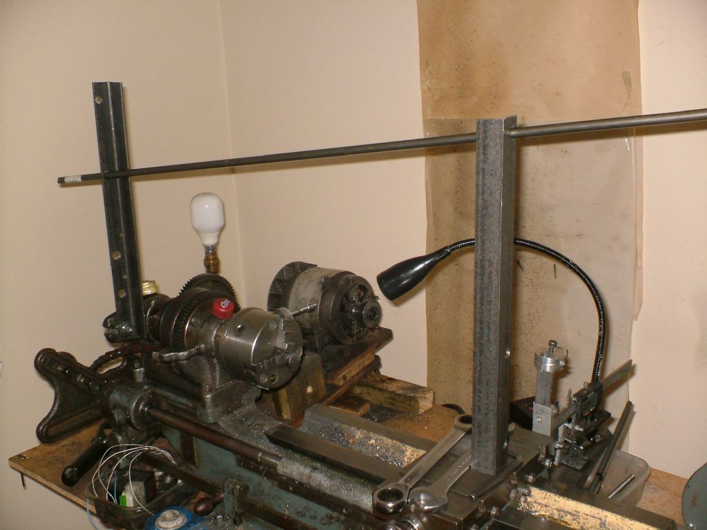

Just a mock up of an idea I had an hour ago
I've got a good lathe and motor and would like to run various attachments from it
I don't want a massive unit, just something which will power any bits and pieces I make for the cross slide
The motor will power the pulley on the lathe spindle with the bullgear disengaged and the backgear disengaged, so the spindle pulley runs independently
and the pulley will power the overhead drive via some good quality 5mm lathe belting
If this works out it means I don't need to bother with any additional electric motors to power my gizmos and attachments
The bits will be angle iron and 12mm rod from B+Q and bearings from fleebay

The idea is very sound, provided that the speed range is what you need.
Generally speaking, it is more convenient to use a dedicated motor to drive the Overhead; and it can be easily arranged that the weight of that motor tensions the belt. There have been several designs in Model Engineer, and J. Malcolm Wild nicely illustrates design and use in his book.

The overhead gantry was spring supported to keep belts taut. It was only used for small scale jobs and would not machine large objects at all
This is going to be the real challenge IMO, transmitting torque
Modern lathe belting is amazingly strong and reliable nowadays which will be a big help
Instant solution number 1
I will drive the overhead directly from the motor with the 5mm belting
It can be removed when not needed
Will take a while to do it right, but it looks like this could be well worth a go

There's a couple of reasons
The original motor can happily run all day doing higher torque work, even my good old bosch drill is starting to give up the ghost from hole drilling in the press. Modern electric motors don't like being worked too hard
I don't want to be messing about with different electric motor mountings and fitting them onto individual gadgets around my cross slide and headstock
I would much prefer to have a simple belt pulley on each gadget where I snap on a small belt and it runs all day if required
This also means I have loads more room for the gadget, there's no motor setup in the way, only a small belt to the overhead drive
If I can sort the torque issue then I can do all sorts of things like a small power slotter for making gears with the workpiece in the headstock as an indexing tool

I guess that could be a useful facility. My only concern is with all that stuff without any guarding whizzing around above the lathe. Be sure that, in your enthusiasm to see what's going on, you keep your hair, beard, ears etc well away from the moving bits!

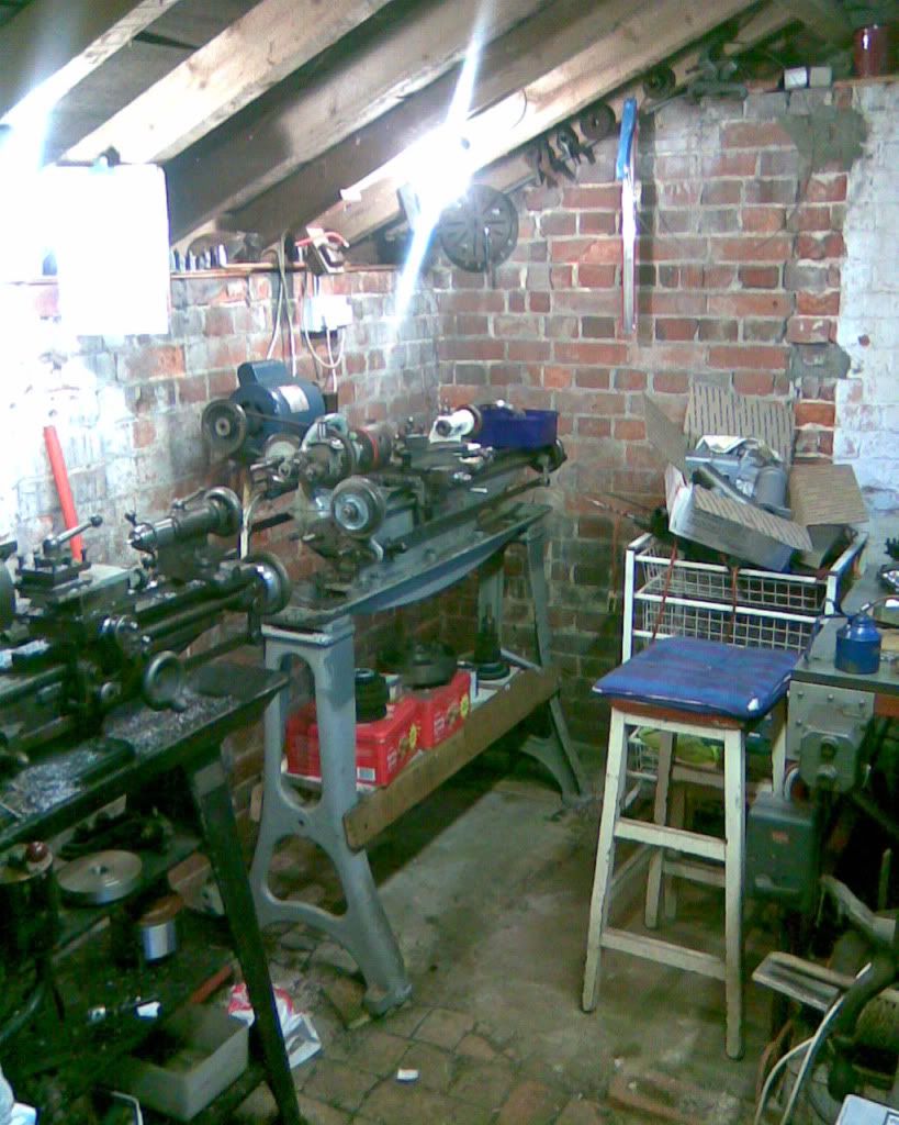

Could you mount the overhead on the wall behind or on the back legs of the stand (if you have one)? That would give you an angled drive towards the back to keep it away from your face.
The shaft can run in Plummer Blocks. Keep the motor low so you get tensioning capability and good grip for the drive belt from a long run.
Tony Griffiths has solid round drive belting that is very easy to join (just done it for a sensitive drill).
I could do the same as I have rafters just above my lathes...just never got round to it...yet.

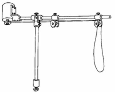

The shaft should not actually rotate, it is there to act as a sliding axle for the pulleys which carry the belting over it if a seperate electric motor is used. The pulleys are allowed to run free and slide along the shaft so that the drive can operate different devices at different positions along the lathe bed.
On the original ornamental lathes where this is a necessary part of the lathe (see links above) the shaft is driven, but by a pulley drive from the lathe drive i.e. a treadle operated flywheel.
A better solution for Ady, if he is using an electric motor for the drive may be something like this below which can be bolted to the bench or perhaps the end of the lathe bed. It would be fully adjustable and can easily be moved out of the way when not needed.  A great deal of torque is not needed for such as a toolpost drilling machine or grinder, speed is more important.
Just another approach,
Best Regards
Terry

I thought of a shaft running the length of the shed with cone pulleys (adjustable speeds) positioned above the lathes for use on all of them (there are actually 3 in a line now... an S7, a standard M and a long bed M to replace the long bed B...yes I know, I'm a magpie).
