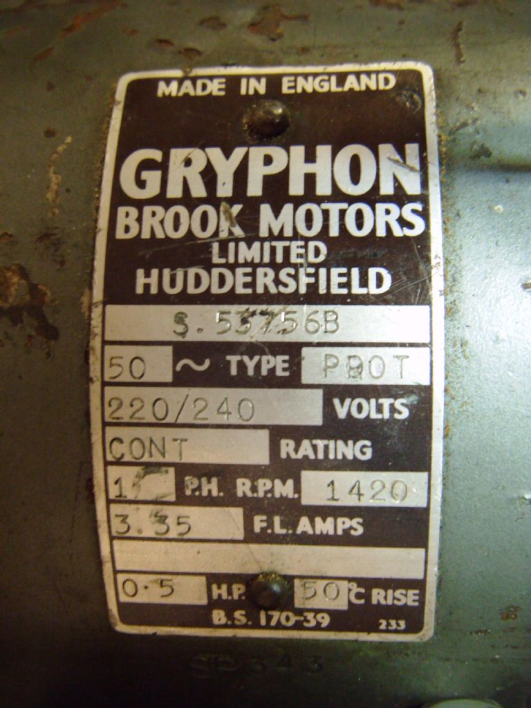

The wiring on my Myford ML7 consists of a household plug, when you plug it the motor turns. It isn't even earthed. The motor has 4 terminals and no obvious capacitors.
Three swiches came with the lathe which are not connected. A start, a stop and lockable forward reverse.
A few questions,
1) Should the motor have a capacitor, if so what specification?
2) The stop and start switches are momentary switches, so to use I would need a contactor of some description. Any advise over which contactor to get?
3) Should I junk that idea and get a Dewhurst switch?
4) Is running the lathe in reverse useful?

1 Don't run without an earth - a wiring fault could prove FATAL
2 Buy a NVR switch with push buttonn ON/OFF. This one is OK and has the advantage of a big OFF button in case of sudden disasters! This switch disconnects the mains feed if the power fails. Without this, in event of a power cut, the motor will restart when the mains is restored. (You could have your hand in there when that happens.)
3 A Dewhurst switch is included in the motor wiring to allow forward and reverse running. You will still need the NVR as the Dewhurst is not designed to break the circuit and , in time, the terminals will burn out if you do so.
4 I don't find it necessary to run my lathe in reverse. There is the problem too, with screw on chucks like on the Myford, that cutting with the lathe running backwards could unscrew the chuck.
Hope that helps a bit

No capacitors needed with that motor, it has a simple start winding. Lower starting and run-up torque than the capacitor start versions but I can't see that mattering on a lathe where you are only spinning up the spindle, chuck etc not trying to drive up against a load.
The NVR Norman suggests is effective and good value for money. Easy to wire as well. Not as durable as a proper industrial rated contactor but I've used similar budget range devices for over a decade when fixing things for other people and have yet to have one come back.
If you decide to use your switches and buy a contactor, any of the lower end industrial devices from RS components et al will be just fine. But do buy a DIN rail mount and a short section of rail. Fitting is sooo much easier compared to the usual "screws carefully placed so you can't quite get on them" set-ups.
Like Norman I'd not want to run in reverse with a screw-on chuck but if you do decide to use a contactor and the lockable forward / reverse switch its best to get the official Brook connections. I have a PDF of the Brook Gryphon sheet covering the full small motor range somewhere if you want it.

I wired up my motor to my push buttons using a contactor and found that when put into reverse it blows the fuse. I don't think I have wired up the button or the motor incorrectly (however not imune to cocking it up).
Having found nothing wrong with my wiring I tried the following, direct from the mains to the motor.
Live to bridged A1/Z1 neutral to bridged A2/Z2 = motor spins clockwize
Live to bridged A1/Z2 neutral to brided A2/Z1 = fuze blows, I would expect anti clockwize rotation if all well?
I measured the the resistace across the terminals,
Z1 to Z2 is 3.6 ohm
A1 to A2 is 3.8 ohm
Z1 to A1 is 0.3 ohm
Z2 to A2 is 0.3 ohm
I am happy to use the motor in forwards only, sounds like I don't need reverse but is the motor running with reduced power.?

I think A1 is bridged to Z1 and A2 is bridged to Z2 internally. Without your bridging wires or any connection to the mains there should be no continuity between the A terminals and the Z teminals if you want to reverse the motor. If there is no internal connection between the windings then the way you say that you have connected it should work. If there is internal bridgeing then when you connected A1 to Z2 and A2 to Z1 there will be a dead short across the mains.

Les,
The motor did have the terminals bridged, removed them and then hey presto - it works.
Now to turn something, actually I need to bolt the lathe to the bench now and check that it is level........
