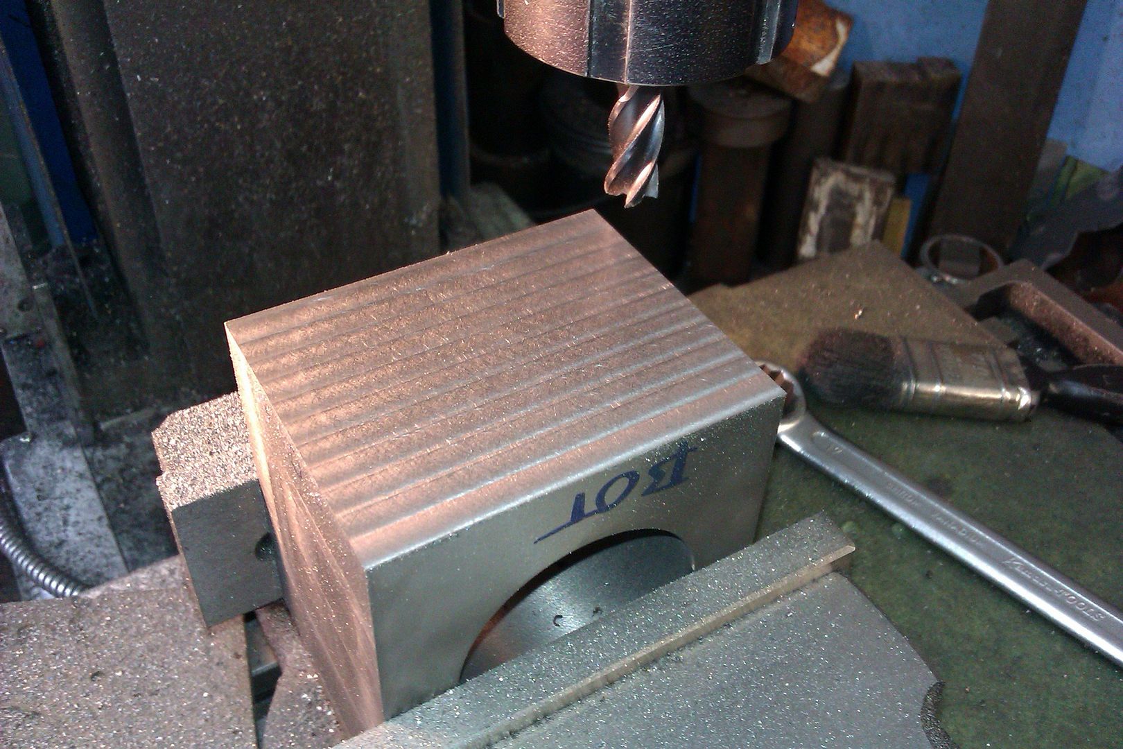

So its basically removing machining marks on flat surfaces in which case same applies drawfile with a dead smooth file if the marks are heavy then emery or your chosen adrasive.
Have a look at this, just emery, I assume thats the look you are after, that was only taken down to 150grit as I don't like it looking too polished, just a nice even satin finish

Bob I think in an earlier post you wanted to remove quite a bit from a similar block so advice was to use more of the edge of the cutter. I is possible to use a sharp endmill to take a series of cut usually about 2/3rds the cutters dia as a finishing cut. This has the advantage over a flycutter of giving a flat surface even if your mill is not quite trammed correctly, I quite often use it to do valve faces etc.
You do need a good sharp cutter and well adjusted machine as if not you will get aseries of nasty looking rings where the blunt cutter gets progressively pushed up off the surface and then bits and drops down again.
