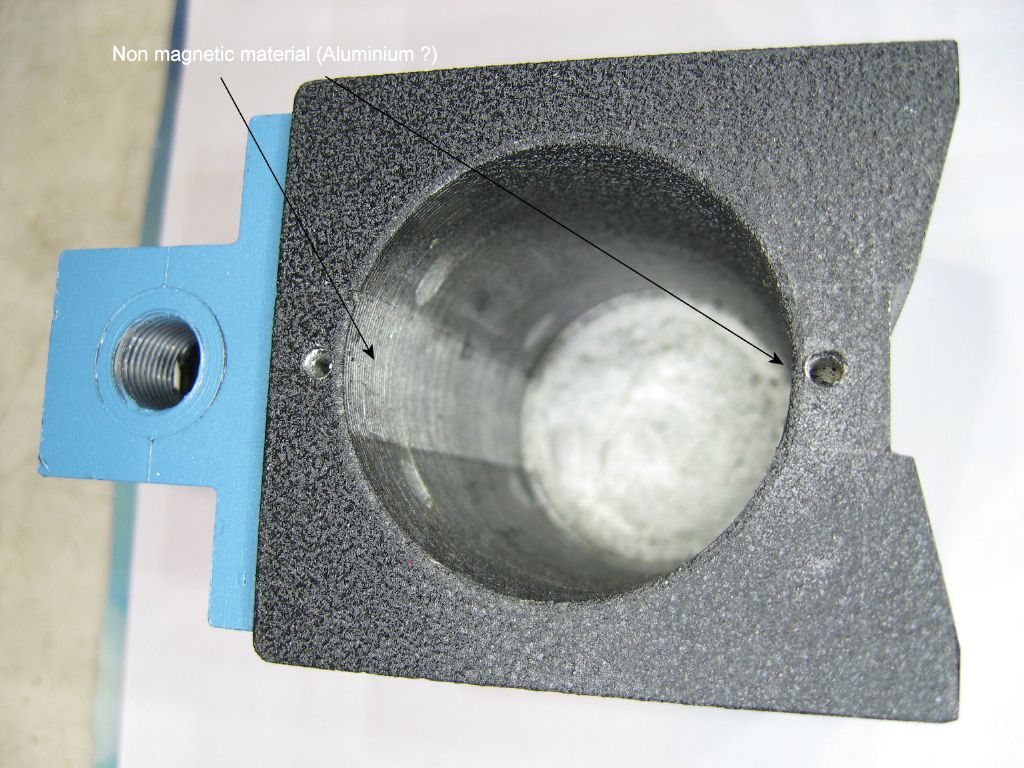

Les Jones 124/04/2012 18:22:33
2292 forum posts
159 photos
Hi,
This discussion made me wonder why the cast iron did not shunt the magnetic path. Looking at a magnetic base it looks like one lump of cast iron. As I could not understand how it could possibly work I decided to dismantle one. I found that it was not one piece of cast iron but two separated by non magnetic material. (Probably aluminium.) The cast iron forms the two pole pieces. This explains how they work. When the poles of the magnet are horizontal a pole is lined up with each pole piece. When the poles of the magnet are vertical they are shunted by the cast iron so there is very little magnetic field.
Here are the pictures of the dismantled unit.
Magnetic base parts
Magnetic base inside
Les.

Les Jones 124/04/2012 22:28:16
2292 forum posts
159 photos
Hi Neil,
It still works when re assembled.
Les.
