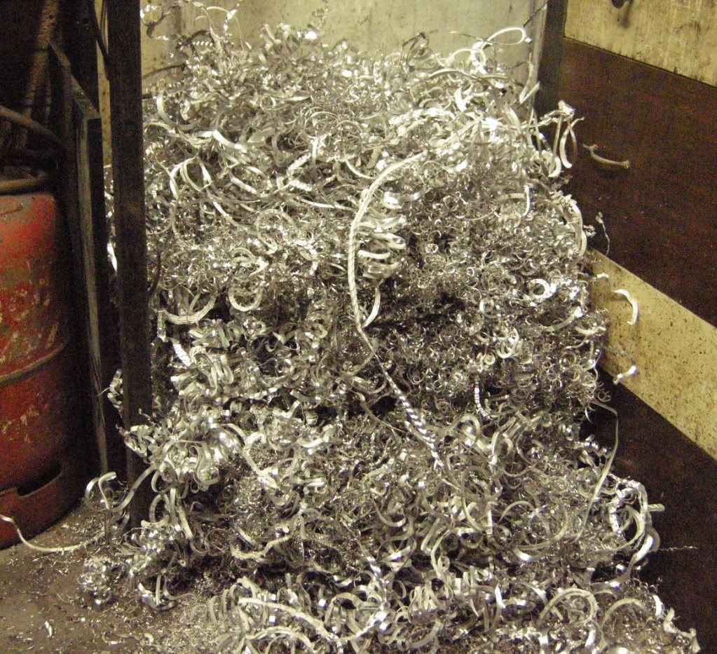

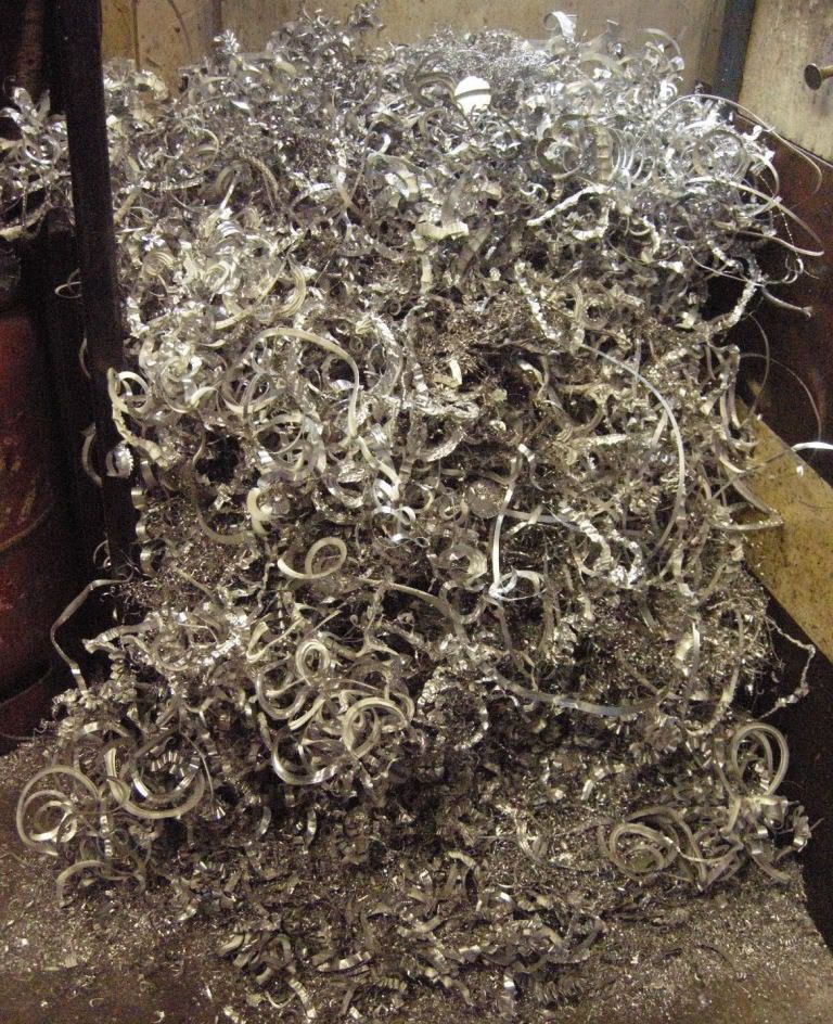

Heres 27 basic type three weeks ago.
Day 1 http://i1140.photobucket.com/albums/n563/Jonhareng/Jons%20machining/T5020offInitialswarf.jpg
Day 2 http://i1140.photobucket.com/albums/n563/Jonhareng/Jons%20machining/T502ndpile.jpg

hehe the swarf looks just like my flats spare room look like some lovley work there mines done now apart from the knurl on the edge but that not a major thing so....... must say tho i am proud of it tho
