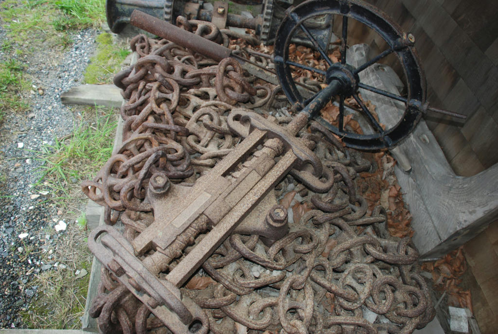

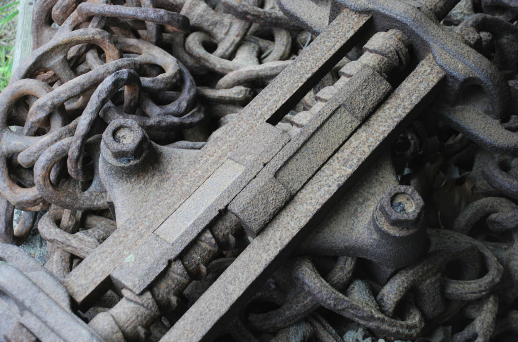

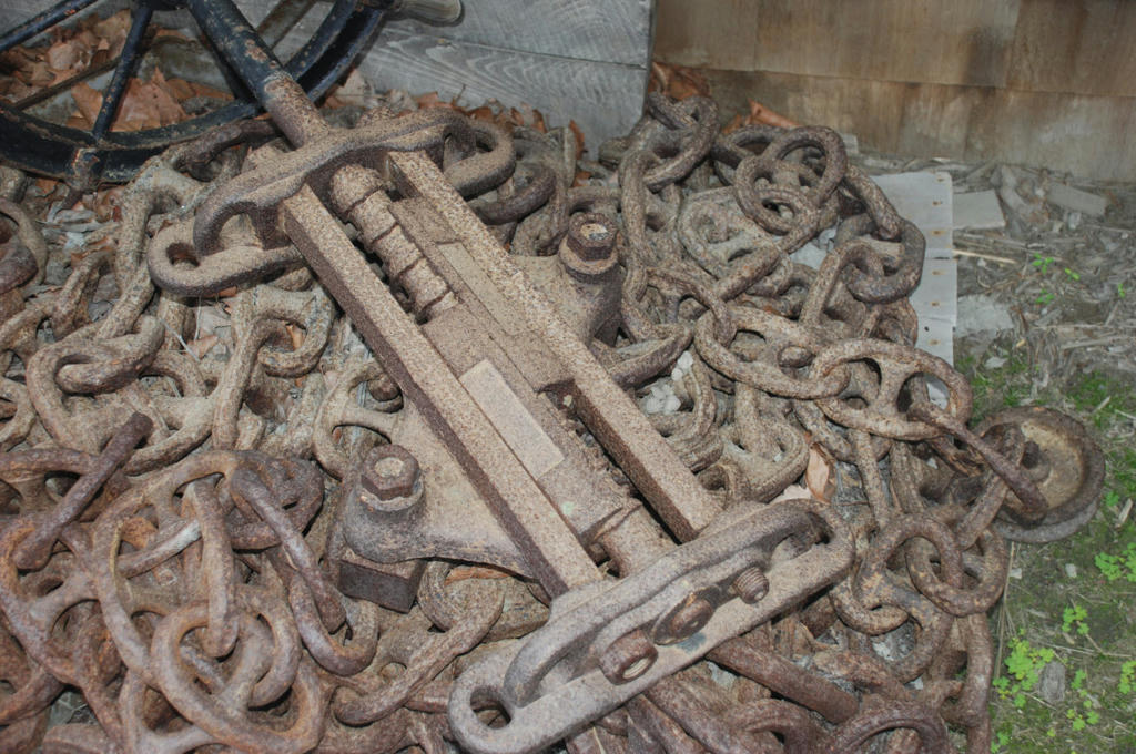

Hi All
A while back I photographed this while across your pond.
I was tempted to make it a mystery item as it is located at the Mystic Seaport museum. Connecticut USA Anyway here it is:
Maybe it is well known among the boat builders here, I had not seen the mechanism before.
A single shaft with two coarse pitch threads running in two directions engaged by two half nuts. Turn the shaft in one direction and one goes up while the other down. perfect for chain or cable driven rudder gear.
Rather neglected I am afraid.
Cheers

Clive Hartland31/01/2012 20:08:47
avatar
2929 forum posts
41 photos
Thats an interesting device, it seems it is able to maintain tension in the two chains/cables as the spoked wheel is turned.
This is the only way to stop the rudder flapping about.
I would think its off a barge or a small tug type boat.
Clive

The screw thread looks an awfull lot like an Archimedes screw to me .
I could be wrong but the level wind on my overhead fishing reel has something very similar to move the line across the spool as i wind the handle .
