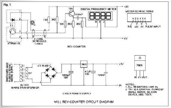

There is a design for a tachometer using simple, cheap components and an inexpensive Chinese 4 digit LED display in issue MEW 147. Although it is a tachometer, I intend to build for exactly the same purpose as yourself. The original article uses an optical sensor (from an old mouse or drive etc) to read a slotted disc. This just needs one slot for recording one rotation of a handwheel or a Hall effect method could be substituted. Here is the circuit as it appears in MEW 147 in the archive if you have access. If not I have a copy I could scan and send for your perusal. The power supply could be based on an old phone etc charger or even a modified computer PSU. A typical 4 digit frequency meter/counter display with 14mm digits is here on eBay at £8.70 with free delivery.but there are others at varying prices as is normal.
Click on the picture for a larger view.

My understanding is that Gray requires a counter that will decrement when the
direction of rotation is reversed so it will keep track of the position of the slide. The counter you describe would always increment.
