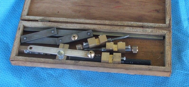

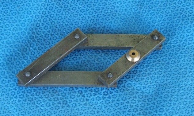

Or you can make up a variant of this gizmo of mine - carefully done they are very accurate and accommodate a range of sizes.
[IMG]http://img.photobucket.com/albums/v332/laneranger/set5.jpg[/IMG]

Hi Tel, that looks interesting, is the bush for marking center hardened, and is it loose so that diferent sizes may be used? I'v got metal cut, ie., 4 pieces with holes at the ends, only need a hole in the center of one of them and its done. Ian S C

Nope, mine is not hardened, but I suppose it could be of advantage to do so. I only made the one bush, which takes a scribing point ground from a concrete nail, which tend to be very consistent size and finish wise - grind the points on the HH grinding attachment with a suitable collet in the end mill fixture adjusted to run with a little resistance - gets the point nicely in the center (which is the point, ain't it?) I'm pretty happy with the way it will automatically pick up the centre of the stock - not always the case with some of the other methods!

I was actually thinking of using it for drilling RSJs as first use. Ian S C

Now that's something I have been intending to do - a version of John's digital gizmo with a cross piece on the standing jaw to help keep the whole thing square to the workpiece - a thing that kept me from ever having much luck with odd leg calipers.
The idea of that thing I made has been around for a very long time - I made mine up as part of a set of marking stuff
