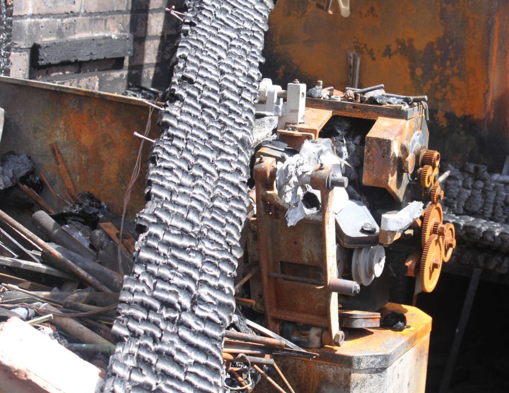

What caused the fire?

My condolances, but lets learn from it. I have an automatic fire extinguisher with a little glass vial like a sprinkler. I just have to be carefull not to bust the vial when I swing a bit of material past it. All my solvents I keep in a metal cabinet (Not fire proof, but would help delay spread of fire).
Lastly, I have itemised all my tools and put a current replacement cost by the side of each, and discussed with my insurers - left them with the list.
I hope you will have the energy to re-build - good luck

Was this a fire at your shop Colin? Could you explain a bit more, other than your question? Hope there were no injuries as a result, shame about the shop and machines though.

No it was a forum members pic on his profile. I last burnt down a workshop in 1989 whilst welding my ford escort and catching the fuel pipe.
KWIL24/02/2011 14:47:01
3681 forum posts
70 photos
Workshop belonged to "Terryd"

Hi All,
the fire was caused by an electrical fault apparently. At least that was the conclusion of the chief fire officer and later the forensic inspector. I lost an awful lot of stuff beside my machines, nigh on 50 years of tool collection, most of my models and two Triumph Stags for those with a long memory.
It was devastating at the time as I said I lost much more than that but at least I was well insured. Most insurance policies do not insure contents of detached buildings or have a maximum imposed, fortunately mine did not. It is worth checking your own policies and then adding up your contents, you may be surprised. Also it is worth taking a video inventory along with photographs of your tools etc. It is very hard to remember all that is lost from memory believe me.
No one was hurt and there was only minor damage to other buildings and it is now in the past. The builders have nearly completed the build and I have purchased a new lathe and milling machine and am just awaiting the handover to take possession. As you can imagine I am filled with anticipation at being able to begin with a clean sheet and design my workshop as I want.

No, the memory is there all the time, I've grown accustomed to it and any regrets are now over. The fault was actually in one of the fluorescent fittings apparently, I also do as you do and ensure that all electrical equipment is isolated before I leave, but my lighting circuit is connected to the security lights and alarm systems so that cannot be isolated.
I also use a fire resistant cabinet but the fire raged for over an hour and a half and it took 3 fire appliances and their attendant firefighters  to control it.  the central support beam of the roof was an I beam 200mm by 100 mm by 7m long which had sagged by around 300 mm in the centre and twisted by the heat.  I hadn't realised how devastating fire could be until I experienced it.

Not wanting to dwell upon the thread but when you mentioned fluorescent fittings a personal bad experience came to mind.
I was in my shop soon after we moved into our current home (13 yr ago) and heard a sputtering noise. I looked where it was coming from and it was a fluorescent light fixture. I walked over, just in time to see a flaming glob of something fall away from the fixture. I shut it off right away and after switching off the circuit breaker I disconnected and examined the fixture. The ballast had some sort of internal fault, got very hot, and the potting material was dripping out on fire. The potting looked bituminous in nature. After a long examination I found some date info on the fixture which indicated it had been made in the late 1950's yet our house was built in 1983. Hmm. Called the former owners and the guy said he had purchased the fixtures used from a recycling store and installed them for extra light in the shop area. I asked him exactly which fixtures these were and immediately replaced them all with new ones and inspected all the other electrical fittings in the house. Found a few iffy items and changed them. Never had a problem since, but every year I remove the fluorescent fixture's lenses and check the temps of all the ballasts in all my fixtures. I replace them every 5 years just to be sure nothing is breaking down over time. This is probably over the top paranoia, but I could have had a similar fire event to yours with the ballast that was dripping fire, and I won't take a chance using old ones again.

My day job is an electrical contractor and I often inspect electrical installations. It is not unusual for control gear (chokes ect) to over heat on failure. If all circuits including lighting circuits are protected by a 30 m/a RCD the risk of fire caused by electrical faults can be redcued. I have also seen a fire caused by a vacuum used to clean up sawdust and swedish oil (used on flooring) which spontainiously combusted. Reading these forum posts reminded me that I use a vacuum cleaner to clean up swarf and any other
material which may contain oil. I must empty the cleaner after use. May be some one with experience in this subject could write an article in M.E. to help us all aviod this danger.
