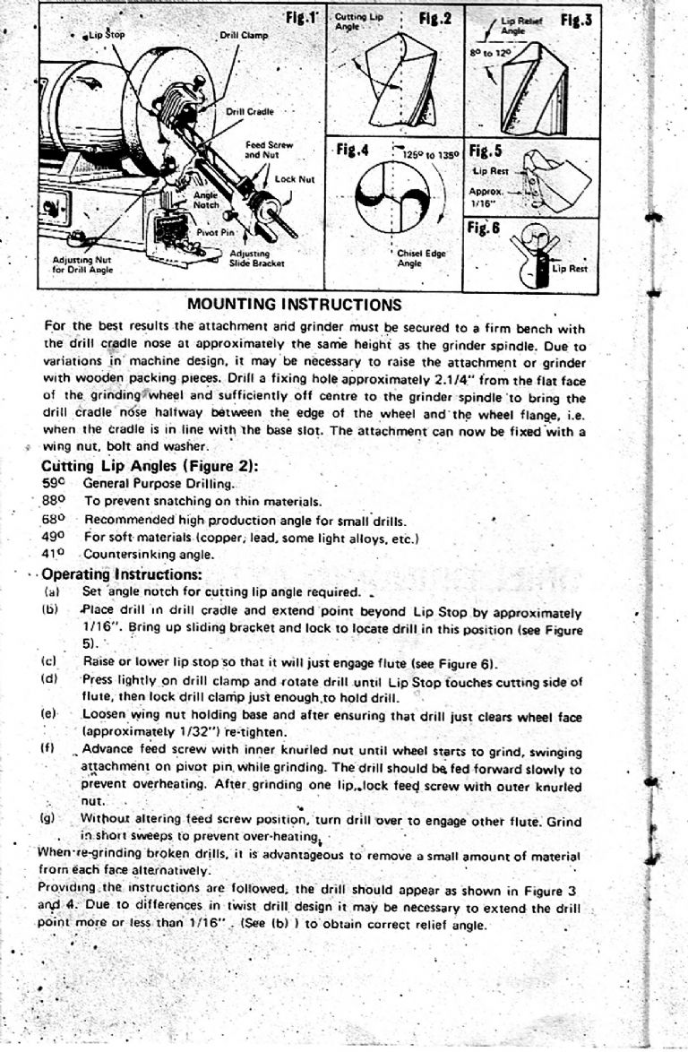

Peter G. Shaw11/12/2010 21:35:16
avatar
1531 forum posts
44 photos
John & Sandy,
Herewith cover & page 1 of my Spiralux instructions. Apologies for the poor quality, the original is 4" x 6.5", scanned by a 1200dpi scanner at 150dpi into Paint Shop Pro, contrast increased and sharpened with the Unsharp mask, finally increased in size to 8" x 12" and then uploaded. I don't know how to make it larger in the forum.  Perhaps if you want a better copy, then we will have to do it by private email - [email protected], but not until Sunday pm at the earliest (going to collect my caravan tomorrow!)

John Shepherd11/12/2010 21:37:35

John Shepherd11/12/2010 21:42:53
222 forum posts
7 photos
Peter
Thank for the instructions - perfectly readable.
