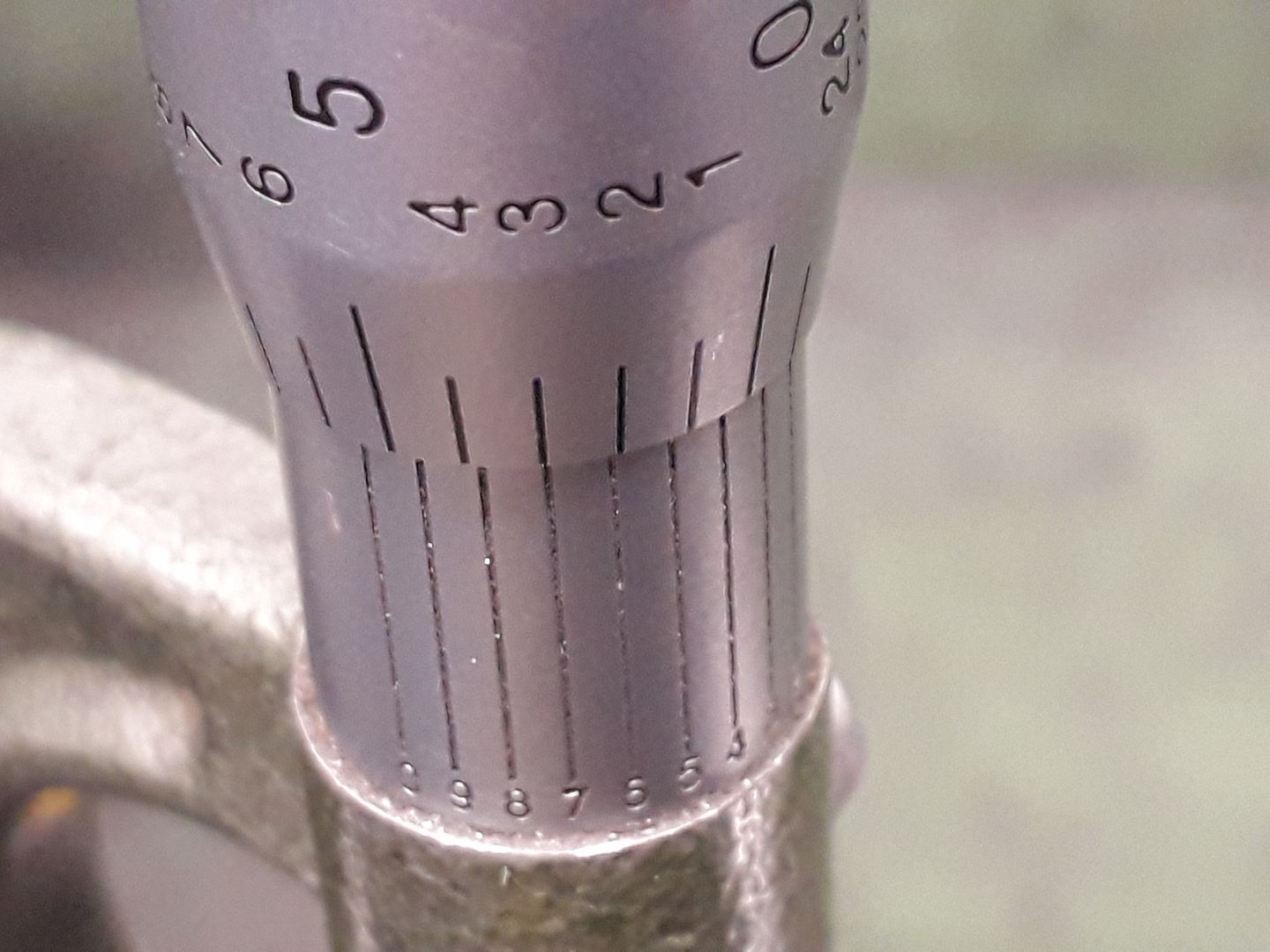

I've never bothered to do anything special when making aero engines even the ones with no rings just split the divisions by eye. Final fit is by feel not measurement. So long as both parts you are working on are at similar ambient temp you don't need to control the workshop temp
Here is the old chinaman taking a 1 though cut to get to 0.3937" (10mm in new money) Insert tool and cross slide set parallel to lathe axis which is a lot easier when working to a shoulder like here than having the slide set over as that also moves the tool sideways as well as a little way in.
And a rare occasion that the mic comes out of the draw looks close to the 7 on the 10ths scale to me
