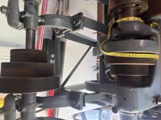

Aston Manning22/05/2023 15:28:32
22 forum posts
16 photos

DiogenesII23/05/2023 17:56:18
859 forum posts
268 photos
..Are there slotted ring-nuts on either side of each of the bearings?
..bit hard to see in the photo's..

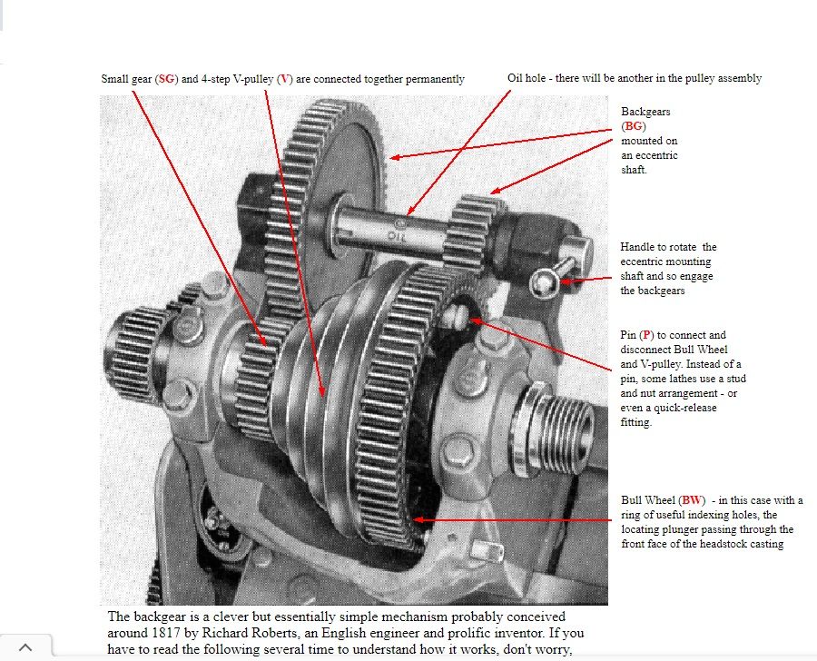

yes it has slotted ring nuts one which screws in to a bronze bearing sleeve furthest from the chuck and two closer to the chuck.I will get some better pictures tomorrow. I'm unable to remove the gear that is for the change wheels it is too close to the back gear to put anything in to prise it and I cant fit a removal tool in I think I have to remove that gear and the rest should come off of the spindle.
It's a similar set up to the picture below

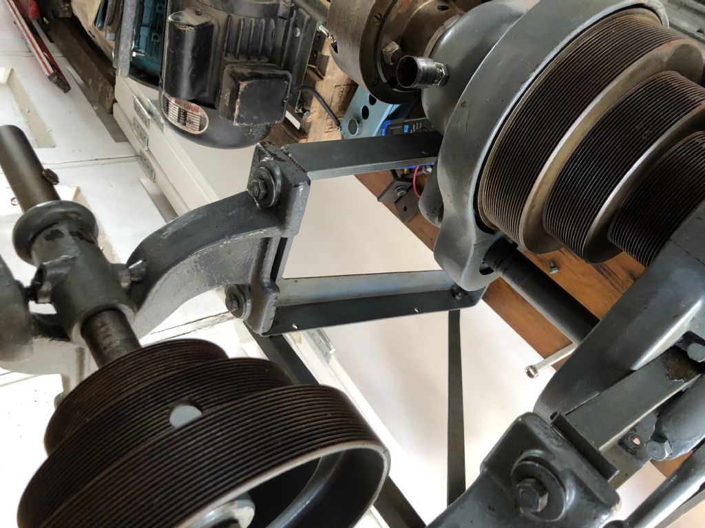

Aston Manning24/05/2023 11:59:00
22 forum posts
16 photos
If I get some time today I'll take a better picture

I might be old and thick, but how are you going to get the belt on without removing the spindle? If all else fails take the bearing caps off and remove the spindle that way. You will be able to see a lot more with it on the bench.
Whoops, having had another look it appears that there are no bearing caps.

So. ..an inboard pinion driving a tumbler reverse (or is it a dog-clutch) within the headstock?

Judging by the pictures of your lathe the photo above is not at all similar as regards the headstock and spindle construction.
The link that Dave Halford gave (a few posts back) is much more relevant. It may not be identical as it does not have the back gear but if its the same make of lathe then the manufacturer will probably have used the same general design and there are enough clues in the drawing that will enable you to proceed.
It looks a really nice lathe and I suggest taking care and not rushing disassembly, hopefully there is a flat or dimple where the grubscrew sits so that any burr does not damage the front bearing (spindle must come out from the front)

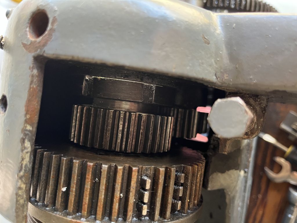

Aston Manning16/06/2023 15:54:13
22 forum posts
16 photos
Does anyone know what the slots on the gear are for? Also any ideas of a way to remove the smaller gear off the spindle there is only a 4mm gap between the large gear and the small gear
