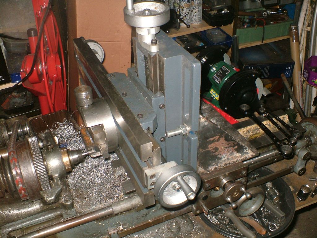

I simply repurposed already capable kit, a Drummond M lathe with a good headstock and a 40 kg milling table so the hard work of decent accuracy and stability was already there, I simply bolted them together
and it still shakes if you take too big a bite, using only 6mm cutters mainly
Only a multi skilled machinist with good resources could make a decent mill from scratch in my opinion, because it needs to be very accurate when it does work, sub 0.5mm across the entire working plane, sub 0.1mm preferred, up/down left/right otherwise it's been a waste of effort
The table is moving horizontally over a dovetail?
The table is bolted "immovably" to the cross slide but can move up and down the lathe bed with the leadscrew
It's actually fabulous for big woodwork jobs because all the mess drops down out of the work zone

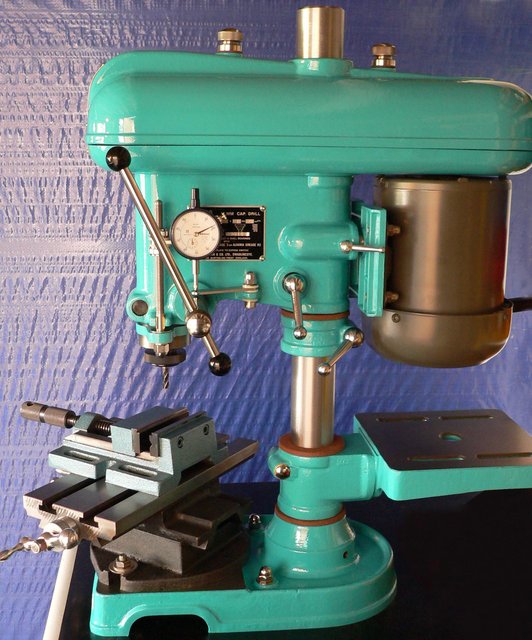

It seems it is possible to use a bench drill if it has the right nose. This picture from:
**LINK**

Posted by Vic on 11/02/2023 16:22:12:
**LINK**
Anything is possible right, and starting with a pretty over-built drill would obviously help... But it may not be easy or cost effective to get the performance desired.
If there's an MT spindle nose and the spindle is bored through (or can be) to accommodate a draw-bar then that gets over one of the two big issues.
You could probably even turn down and bore out a solid spindle with an external screwed or JT nose to fit an internal MT2/3 ISO20/30, or ER32 taper, provided it has enough "meat" to it.
There's also the consideration of how rigid the bearings are with respect to side-loading, most cheaper drills will use one thrust bearing at the bottom and one or more deep groove bearings further up, that will result in deflection during side loading and quickly destroy the bearings.
High-end drills sometimes use angular contact ball bearings instead which may be able to cope with milling forces depending on their arrangement in the spindle and pre-load forces.
Depending on the existing bearing seat sizes and how they're pre-loaded one could fit angular contact or taper roller bearings to improve a spindle for milling.

Posted by Jelly on 11/02/2023 16:46:47:
If you click on the link you’ll see it’s pretty much a standard Fobco Star bench drill apart from the nose and a couple of other minor bits. Nothing “over built” (whatever that means?) that I can see.
**LINK**
Something like this may well suit the OP?

The Fobco is built very solidly, out of substantial castings, and uses a very rigid spindle design, which includes a pair of angular contact bearings preloaded against each other, which is not unlike the arrangements used in many modern "hobby" milling machines.
Compared to a more modern drill press, that definitely qualifies as being over-built (as in the design and materials of construction significantly exceed the minimum required to do an acceptable job).
My experience using Fobco drills is also that the fit and finish of the quill and the bore it slides in is also unusually high by modern standards, as is the inclusion of a quill lock of the highly rigid split casting type.
As such it is actually uniquely suitable to be re-engineered as a lightweight milling machine, in a way that very few drill presses actually are.
My big drill press is an early '90s Sealey with an MT3 spindle, and is far more capable as a drill than a Fobco star is, as well as seeming like a far more substantial machine...
But in reality it's internals have been heavily value-engineered to give maximum drilling for minimum money, so it would rapidly shake itself to bits if used for milling.
OP needs to be aware that not all drills are made equal, and if he wants to go down that route he needs to examine parts diagrams or sectional drawings to understand if the construction of the spindle is suited to conversion to milling.
