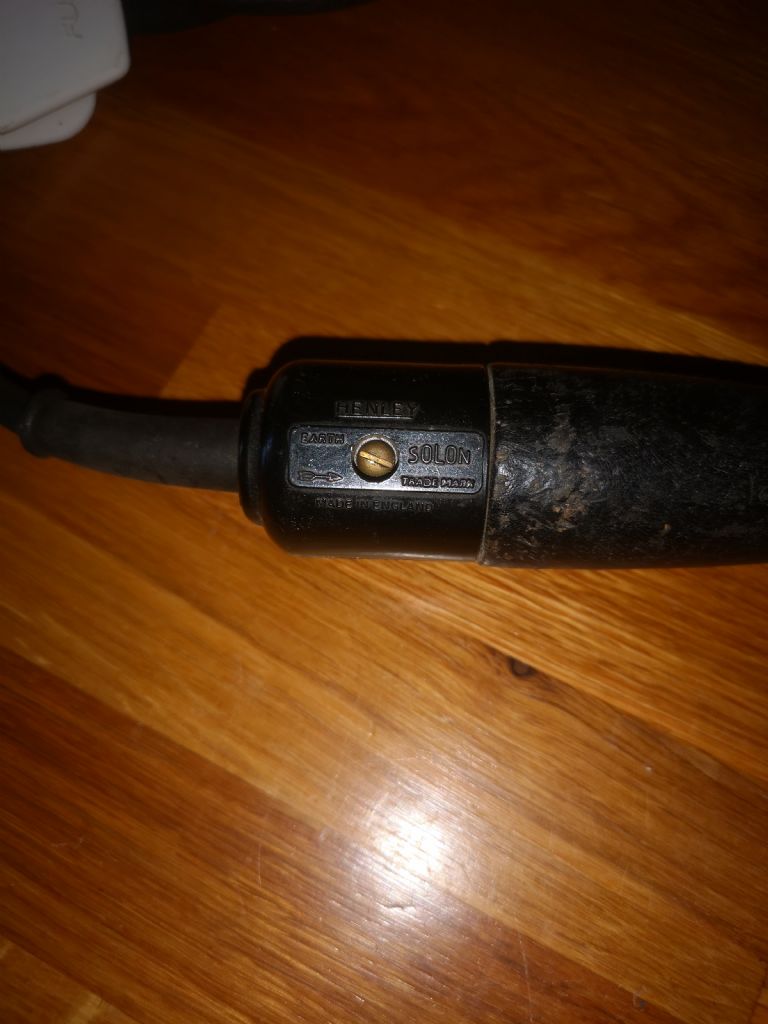

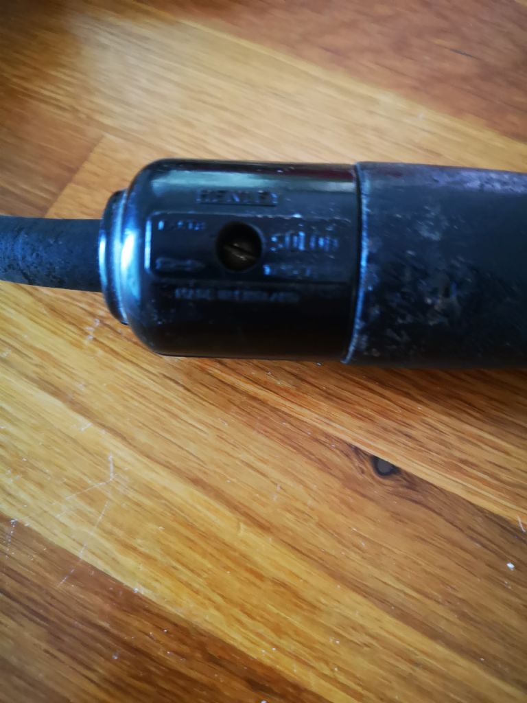

img_20230206_123237.jpgI was wondering whether anyone has had any experience and success repairing this type of soldering iron? It has taken to tripping out the electrics from time to time. I shall change the lead as a precaution, but would welcome any other suggestions or advice from experience that people have.
James

I'd replace it unless certain the cable was the problem, (Quite likely it is, but be sure.)
Last thing electronic work needs is a soldering iron with an earth fault, and it might burn the house down after shocking the operator too.

I would guess that the element is leaking to earth and needs replacement. Whilst you are looking for the Henley Solon replacement elements, buy a packet of spare hens teeth whilst you are about it perhaps?

Looks like Henley Solon iron so quite elderly and (depending one which model/wattage) not ideal for modern electronic equipment.
If there is leakage to ground in the element then its toast, if its just a wiring or cable fault then its an easy repair.
I would put it on ebay (they seem to be wanted by some collector or enthusiasts) and get a new proper new iron

Hi James, I have a 250 W one of the same make and that does the same thing, I keep meaning to run it from an isolation transformer to see if it will carry on working with an earth. I did have an old spare one, which the casing around the element was failing, but the elements on that one were shot, and while taking it apart, the mica insulation just fell into pieces, so I guess the mica in yours is breaking down. You will indeed find it hard to get any spares for it, so unless it is the lead at fault you may as well scrap it. They do have a good copper tip though, which you may be able to salvage and fix to a handle via a steel bar, and then use it the old way by heating it up in a suitable flame, which is what I have been considering to do with the one that I took apart, which I still have.

This throw away society, has to stop. Just ask your friendly electrician to carry out a simple insulation test for you, a five minute job, that will determine what is wrong. Apparently the elements are rare, didn't know that, what is the wattage? If you locate a new element it is an easy job to change it. You might need to change the screws as well as they get corroded up then the threads strip. Some times its the rubber flex which hardens with age, simply crumble away inside the wooden handle causing short, not to earth but live to neutral. The local "Mates Shed" has a box full of donated new ones, some in cardboard sleeve if you send me a PM perhaps they might sell you one. John

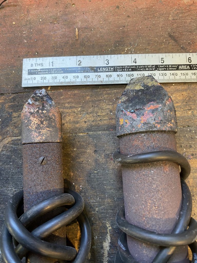

Hi Speedy Builder5, a photo of my 65 W & 250 W irons, which the copper bits are 18mm & 44mm wide, the big one does take a fair while to get hot though.

Hi John Haine, no cheap plastic on these, the handles are wood and the covers over the lead connections are Bakelite, and their quality is a long way upwards from your description and they have both done a fair amount of work in their long life.

To anyone contemplating stripping the element out of theirs for a service be advised that they do contain what appears to be asbestos and it's quite friable so only attempt this if you're aware of the risks and precutions. You don't want 5 million fibres in your lungs just to save a tool you can get for a fiver at the boot fair.

The warning about asbestos is welcome as I had not considered that. I shall try replacing the cable and leave it at that if it still trips out.
I realise that the iron is ancient and that spares are not going to be available. However, having bought a couple of new higher-wattage irons that failed very quickly, keeping this going if possible has its merits. I use it for things like replacing the mesh on my Austin 7 oil filter frame and repairing the cover of an early dynamo cut-off: I have a temperature controlled iron for electronics.
