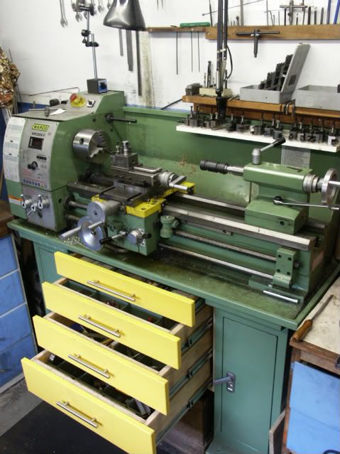

I got the stand when I bought my 280 back in 2008 and used it like that for about 2 years. Then decided that the panel in the middle was wasting a lot of space so made a draw unit to replace it, probably did not add much to the rigidity but happy with what comes off the lathe which is what matters to me
