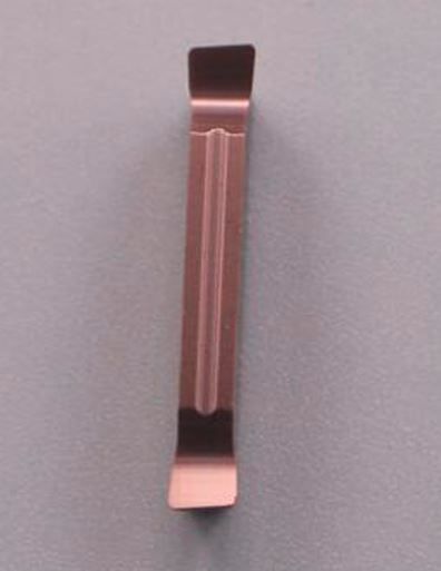

79059a55-7a3c-4d9c-b680-11036efdfe7c.jpegb5a3c78d-5630-401d-bb76-1f9d8d3d0239.jpeg96ffa397-ed7e-4c87-a6f1-dcccfb5f5e80.jpegHi, hope someone can help.
im having a bit of a nightmare using this new parting tool that I bought from arceurotrade.
I haven’t been able to part properly with it yet and have already broke the original blade, good job I ordered a spare with it. I’ve tried all 3 speeds of my Myford ml7 lathe, still without any good results, just keep getting chatter or the chuck stopping and wedging into the tool, thats how I broke the blade that came with it.
as you can see in the photos, the blade is spot on the centre cutting height, it’s an 8mm by 10 tool holder and lines up perfectly, so I can’t understand why it’s not cutting through properly.
hope someone can tell me what I’m doing wrong, would I be better using a Hss parting tool instead.
thanks

I would not trust a MT shank held in a 3-jaw to be on ctr height. Put it in the spindle taper or try against the tailstock ctr

A centre held in a 3 jaw WON'T be on centre, unless myou nhave an exceptional chuck.
It is likely to run out by anything up tom 0.005" on a reasonably good chuck, more non a worn one..
You should set to a centre, located in the 2MT bore, and recently trimmed up.
Use a 2 MT centre, not a parallel one in a 3 jaw!
You would spend time profitably, making a Centre Height Gauge, It would aid setting tools to centre height considerably.
This might be part of your problem! (Looks to be on centre but may not be . If too high will cause problems)

Personally I wouldn't use a tool like that for parting off. They're more of a grooving tool. Carbide parting off inserts will chatter badly if the feedrate is too low. I use power cross feed and a absolute minimum of 4 thou/rev. If you're not confident to let rip then HSS is more forgiving.

Re set the tool so that it is 5-10 thou above centre. 5 thou should do, but if the tool and compound are dipping with load, the higher amount might be needed. .
This is more important with carbide parting inserts than with HSS. The very last thing you want is for the work to climb over a carbide parting tool. Instant failure.

Check that the tool os running true to the run of the slide. It needs to be like no more than 1 thou or 0.03mm per 20mm of travel. Also assuming that the top slide and the compound slide don't have sloppy gibs. That looks to be the multi direction turning insert, rather than the Parting specific insert. The difference is the the top rake is positive and a sharper front end with a geometry that curls the chips better. As Jason said, a feedrate of about a thou per rev and upto 45mm in diameter under 500 rpm works, but at around 250 rpm, coolant does not go everywhere. It needs plenty of coolant for best results. Parting tools should be on centre to slightly above. The reason for the success of rear parting holders on older machines, is that as the tool tries to lift, the slop in the gib tightens the gap, making it more rigid.

I've got one of these; I've found it to be very fussy about feed and speed. My lathe has variable speed control so I can twiddle the control knob to find a speed that works. The feed needs to be pretty brutal - anything less and it will chatter badly and the swarf comes off as a powder. When you get it right, it works well, but most of the time I find an HSS blade less hassle.
edit: I think the insert on mine is different - it has a shallow groove in the top, which I can't see in your photos, and its single-ended.

As Mark Rand says, carbide parting off should be above centre height. I have read the instructions from Kyocera and Kennametal and both state that the tip should be 0.1mm, 0.004" high when parting solid stock.
I never part with anything but carbide inserts and have never seen two streams of swarf coming off. The profile of the tip makes the ribbon curve longitudinally like a length of rainwater gutter which is then narrower than the width of the cut.
Any loosness in gibs or flexibility make parting much more difficult. I have a solid block with inverted blades which bolts directly to the cross slide and together with front and rear saddle locks, is used for the most challenging parting.
A four jaw independent chuck and the minimum work overhang also help.

The stickout length would be the same with the similar type I use, but mine are 20mm, so the stiffness would be better. The design having a double ended insert makes that type rather long which is unavoidable.
