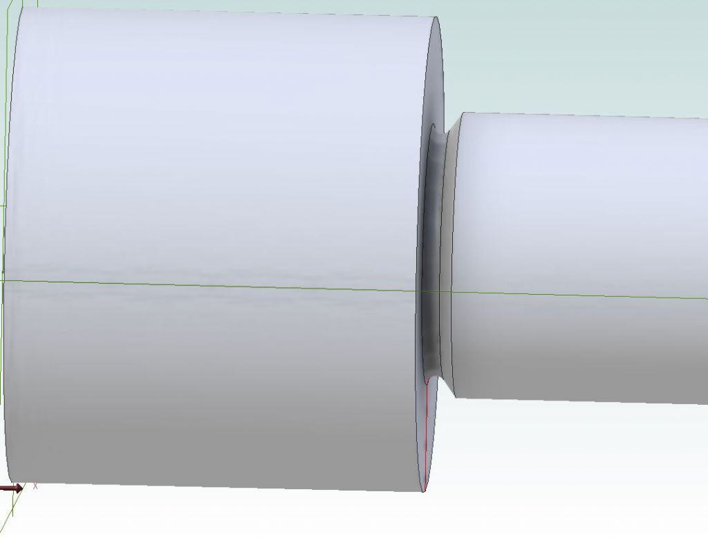

Must admit that for the purpose of undercuts that the OP wants to do I've taken to using a DCMT or DCGT insert to do both the initial turning and then the undercut which saves having to change tools and also gives a nice rounded fillet to the root of the undercut which should be a lot stronger than a square cut one.
undercut.jpg.

Having worked on Swiss instruments I noticed that the did not do undercuts on shafts, but did recess facing galleries. These better to retain any lubricant' To my mind an undercut gives a weak point on the shaft at the junction of main body!
Not if you only undercut to the root diameter and have a radius on the left corner of the tool (looking from the top).
