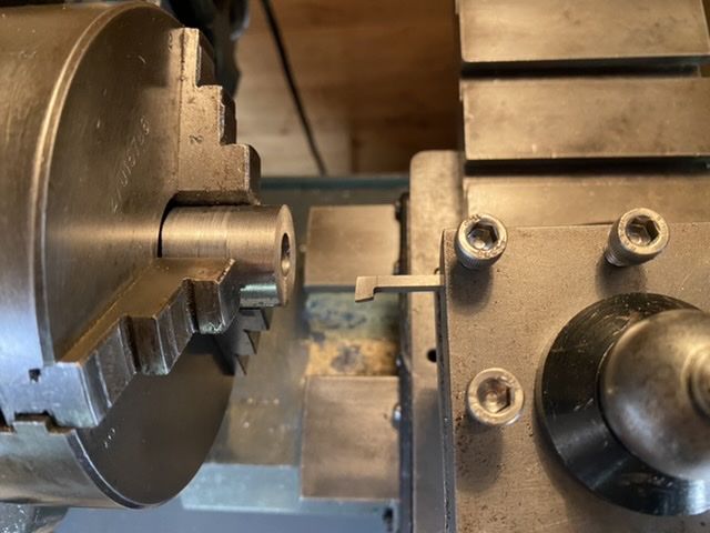

92d127d7-c87e-4c27-a41c-45f39acce1c4.jpegHi,
im having a bit of bother trying to use a boring tool.
as you can see in the pics I can’t progress the tool any further on the cross slide, this is as far as it will go.
any ideas, what am I doing wrong here.
thanks

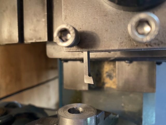

Try rotating the top slide so the handle is nearer to you and wind it right in. Adjust the toolpost so that it is still at right angles and that should put your tool a bit closer to the lathe axis.

Difficult to say for sure but it looks as though the tool is as close to the back of the slot in the toolpost -- you can probably move it outward towards the machine centre thus putting the cutting edge closer to the machine centre.

there must be more to it than that as all my machines will send the tool post past the centre line

Plus one, there has to be something fundamentally amiss here. A picture taken from futher back would help, so we can see the whole picture, so to speak!
Just checked on my lathe (Harrison M300); when the cross slide nut is about to become disengaged the axis of the lathe spindle is roughly aligned with the centre of the 4-way toolpost. So a tool as shown would be well past the work centre.

I’ve tried it every other way, but it will not move past where you see it in the pictures, maybe it’s faulty somewhere.
I’ve only just come across this because it’s the first time I was going to use the boring tool, seems strange to me.

A quick checklist;
..there's nothing fitted under the nose of the cross-slide to act as a 'stop'?
..there is nothing attached to or protruding from any of the cross-slide T slots to act as a 'stop'
..you can still see some feedscrew threads under the slide at 'your' end?
..have you got the tailstock pushed right back out of the way at the end of the bed?

Have you loosened the tool post on the cross slide and slid it along the tee slot towards the chuck. For a tool this small some tool post overhang towards the chuck should not matter as long as the tee nut is fully inside the slot.
Another thing to consider is the use extended packing above and below the tool to allow it to stick further out of the tool post. Are you clamping with three screws? You will not need three clamp screws on this tool, two will be enough.
