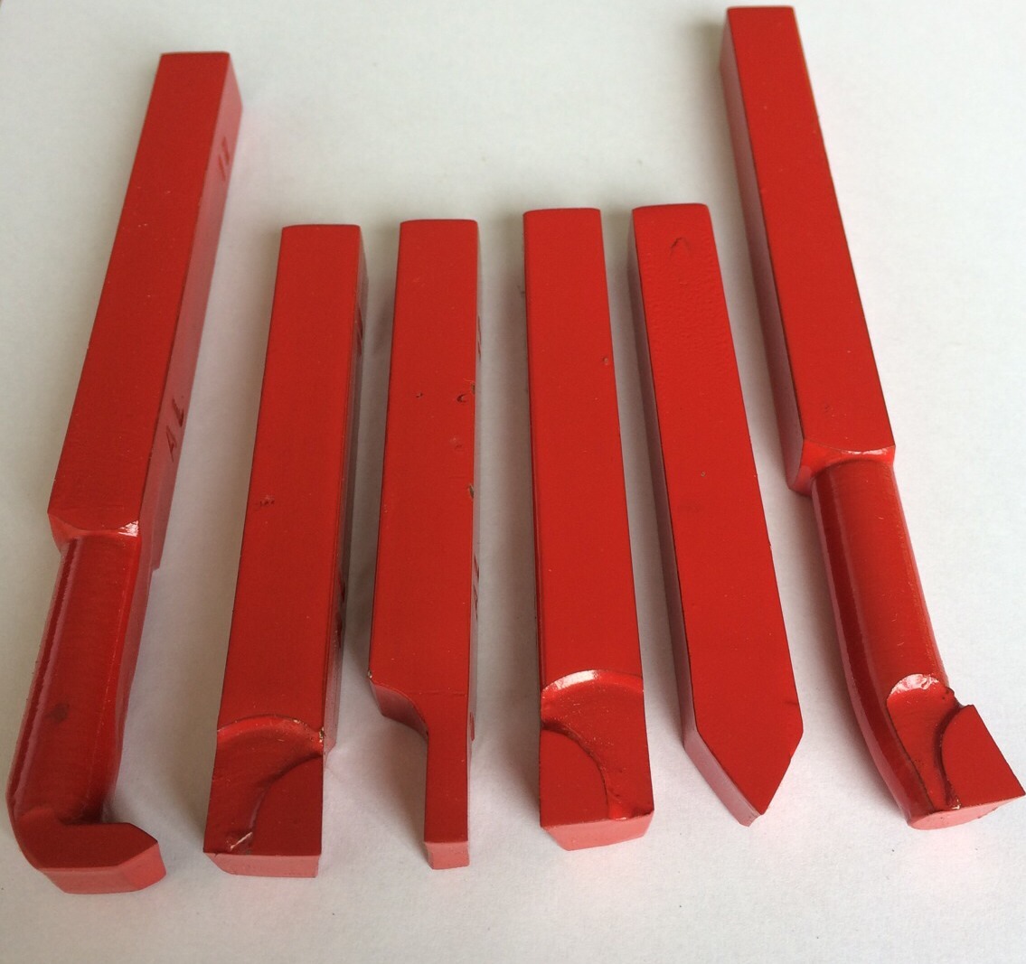

I'm in the market for some new tooling.
What's the best value sets available and where from?
I'm looking for a set of pre-ground HSS and a set of carbides. Preferably including boring and basic thread cutters...
Thanks

I mostly use carbide inserts with HSS as backup. Apart from home-ground form tools. my most used HSS tools came from this set, which I got years ago from Arc Euro. All used in anger apart from the 55degree threading tool. I broke the parting tool, and prefer something sturdier.
The range of inserts available is bewildering: Arc Euro sell a subset which happen to be a good match to hobby needs.
I don't recommend brazed carbide lathe sets resembling these:
They often arrive unsharpened and have to be touched up with the green grinding wheel mentioned by David George before use: bit much for a beginner I reckon. Must be useful for something, but to my mind they fall awkwardly between two stools. In my workshop they lack the massive convenience of carbide inserts and the tolerant virtues of HSS.

Before the advent of inserts brazed carbide was recommended for iron castings to get under the skin, complete with sand, and to get through chilled area. i've got a few industrial ones from way back but haven't used them for decades. Carbide inserts work well, even for tough and hard materials. Plus the castings for my engines seem to be old school as they have never had any hard spots.
Andrew
JasonB06/07/2022 16:26:24
avatar
25215 forum posts
3105 photos
1 articles
I use the brazed carbide knife tools with radius ends to put a nice internal fillet on things so they get used reasonably often. At the time I made my Minnie 90% of that was done with brazed tools from MESAS and they are the same ones I'm using 30+ years later with a few additions.
As Andrew says also stand up to crusty castings far better than HSS
New ones can be touched up on a diamond lap as the basic shape is there, just need to crispen up the edge so a green wheel is not needed from the off.
