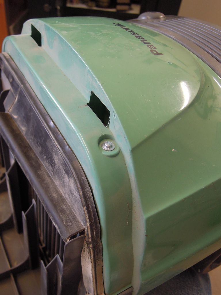

I'm just trying to dismantle and clean up a 25 year old Panasonic vacuum cleaner and find that the main casings are held together with anti-tamper screws. I managed to get the only exposed one out with some pliers but the remaining three are down some long holes so I'll need a tool to get them out.
They look like male versions of a multi-spline (actually 6 splines) socket headed screw.
I've never seen anything like this before, or a driver for them so I'm just wondering if anyone is familiar with what they might be officially called, what's needed, or where I might look for a tool ? Any help would be appreciated.

Looks like ‘System Zero’
**LINK**
https://uk.rs-online.com/web/p/security-screws/3007616

This tool would appear to be a bit cheaper; I suspect drilling out will be tricky as they are hardened, but having already extracted one, and being hardened, it might work as a form tool to make a suitable depression in the end of a metal bar.
Last time I had one to remove, I made a slotted spade bit out of an old screwdriver, but fortunately the screw wasn't too tight; obviously there was only two points of contact, rather than six.
https://www.millsltd.com/default/mills-system-zero-tamperproof-screwdriver.html

Funnily enough I had to tighten one of those screws in a power supply today. I made it slightly less loose using a pair of pliers. If I had more time (and this may be your best / cheapest solution) I would have taken a straight bladed screwdriver and ground a vee in the blade. I think it should should work well enough for a one-off.
Alternatively, is this the same screw type found on Gameboys, etc.? If so, the correct tool can be purchased cheaply.

+1 for slotting a screwdriver. You have an extracted one as a pattern which makes it easier.
Single blade will be ample on self tappers in plastic but its a bit of a technique to keep the blade central and driving properly in a deep hole. I found going sideways was easier than going straight down.

Since many of you took the time to send your thoughts and suggestions I just want to let you know how the story ended. Since it was a Saturday and I wanted to get the job wrapped up, I made a quick check of the local stores online to see if anyone had a 'system zero' screw driver in stock. They didn't, so set about profiling an old flat-bladed screwdriver as several of you suggested. dscn8901.jpgThis went well and was able to reinstall and the remove the previously extracted screw with reasonable success. It seemed then that it was all downhill from there, but when I attacked the remaining security screws I just couldn't make my new tool engage at all. Clearly something wasnt right.
I did mention previously that these 'screws' were located at the bottom of deep narrow holes. As such they were not at all easy to see. To cut a long story short I began to doubt that they were screws. Infact with more careful inspection, they resembled rough rivet heads. But this just didn't make sense. Why would anyone do such a thing ? I did some googling and found a service and maintenance instructions on the internet for a very similar model. This document basically said "remove the "safety" screw and pull the casings apart" ! So I did, and it worked ! It subsequently turned out that what I though were 'screw heads' were just injection pips!
Dismantling the machine thereafter was a dream. Every component was snapped together and was very easy to separate, wash and re-assemble.... and not a single one of these moulded clips broke in the process! Panasonic clearly put a lot of thought into this design, robust parts and nicely productionised.
....and there wasn't anything wrong with the motor bearings after all. The squeaking was the brushes, and even this has now disappeared after a long run. The "safety" screw by the way has been re-homed in the bin.
