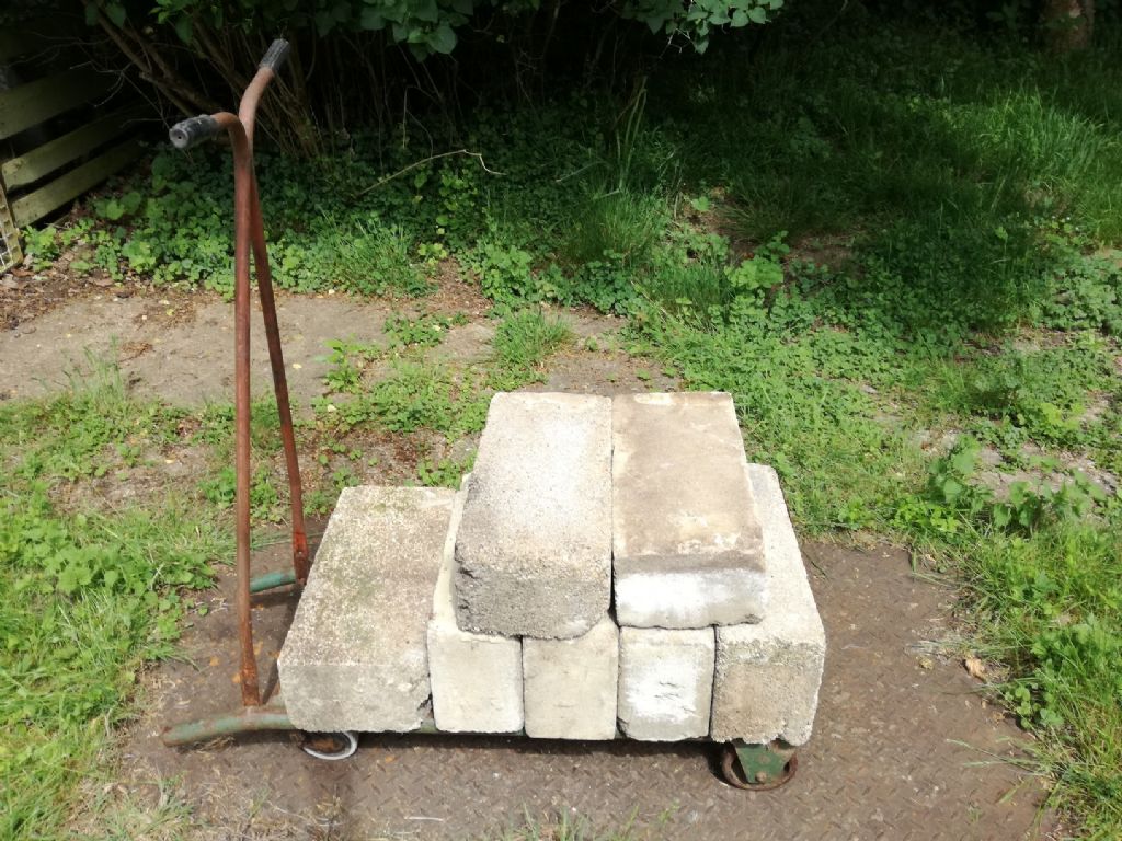

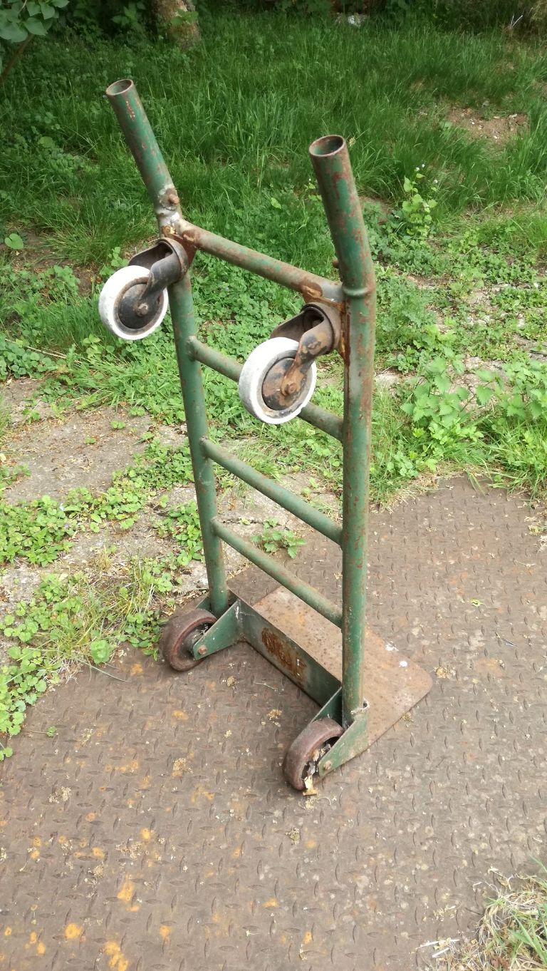

Hi, talking of sack barrows/truck, I made this one about 25 years ago.
It can handle a fair load as a truck, shown here with some concrete blocks and could have had more on, but these were all I had handy. The handle is just sprung onto two short round steel spigots and it came from a scrapped push lawn mower.

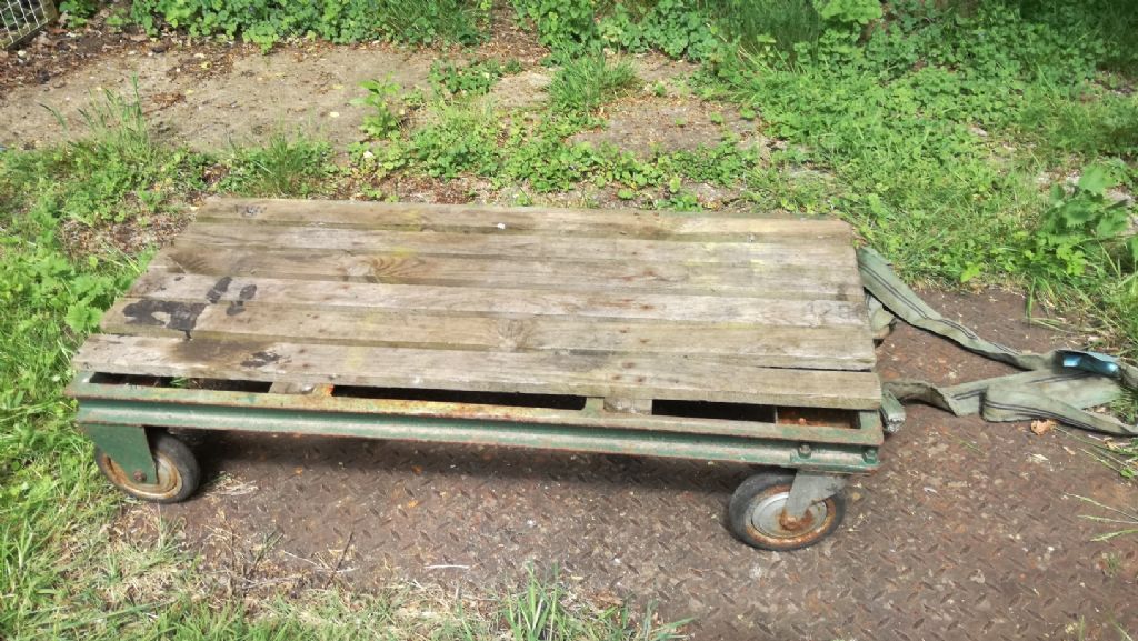

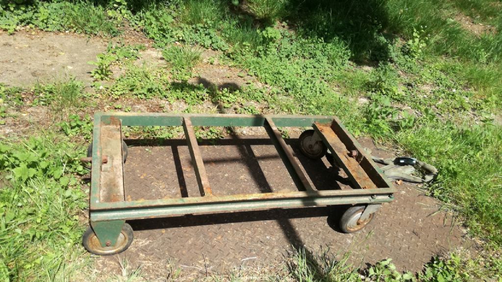

This trolley I made around about the same time, is 1100mm long by 550mm wide and the wheels came off a scrapped industrial Nilfisk vacuum cleaner similar to this Nilfisk 53 L50 LC but a much older type and with a 100 litre bin, I've had several very heavy things on it and it will go over rouge terrain dry grass without too much trouble, but of course the heavier it becomes, the more effort needed to pull it, but the ball bearing wheels with the 160mm diameter by 30mm wide, rounded edge solid tyres help.
It has its own bespoke duck board which can't slide in any direction because of two cross slats inside the frame.

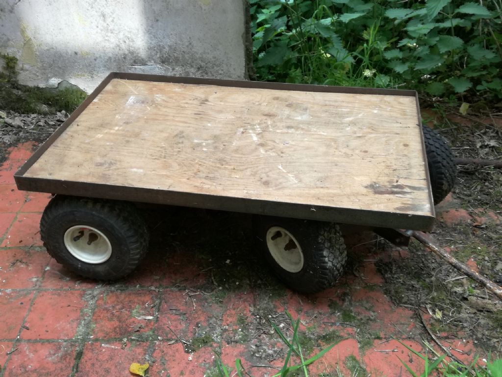

Then there is this lighter duty one with pneumatic tyres, which is 900mm long and 770mm wide, which has had a few more of those concrete blocks on than shown above and was pulled over about 50 meters of rouge ground without undue effort.
All three will fit in the back of my estate car, but not all at the same time, but my two younger sisters borrowed the sack barrow/truck and the trolley with the pneumatic tyres, to shift several 20KG bags of sand about half a kilometre from one of their house to the other and had no trouble doing so and both the sack barrow/truck and trolley went in my estate car easily at the same time. I do have a bought aluminium fold up sack barrow, thought I wouldn't trust it with any great weight though.
