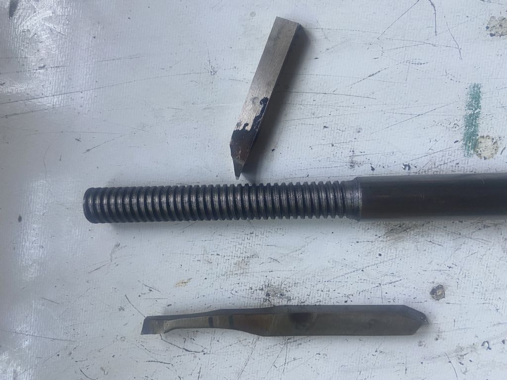

Hi again
A few days back I cut myself an Acme thread as a test piece, 5/8” x 8 TPI. It went pretty well. To do it I made an Acme cutter (see pic).
Next step is to practice making an Acme internal thread to fit. I need a suitable internal Acme cutter. I made a “boring bar” a while ago (also see pic), which I’m quite proud of because looks a bit like the Loch Ness monster. It works however. I want something similar but with an acme cutter on the end. The reason for it’s strange shape was there was so much grinding I did the coarse grinding with an angle grinder and a flap disc.
Surely there is a better way to create an Acme internal threading cutter?
Steve

YOu can buy boring bars that are a round shank held in a slotted square holder. The end of the round bar has a cross-ways square hole for a piece of 1/8" or 3/16" etc square HSS, which is held in place by a small grub screw coming in from the end. You then just grind the piece of HSS to the shape of your Acme profile. Put it in the boring bar and cut off the long unused tail of HSS sticking out. Easy peasy. Just be sure to grind plenty of clearance angle on the leading face to allow for the helix of the thread, which can be quite a bit on small acme threads.

5/8 X 8 ACME internal threads would normally be done with a two stage tap about 10 inches long, as trying it on a lathe with any type of threading bar would be very difficult because there is so little room. I produced nuts in 3/4 X 5 ACME by using an 8 ACME laydown insert in a ground down bar to remove some of the metal, up to its depth limitation and finishing with a tap. This was because I was afraid of snapping the tap if I tried to do it in one go.
With 5/8 x 8 ACME, the starting hole is only 1/2" diameter.

Steve35515/04/2022 11:26:11
321 forum posts
235 photos
Posted by Hopper on 14/04/2022 10:24:57:
You can, but those bars are 3/8” diameter and the DOC is 1/8” for a 5/8” acme thread. That has to fit into a 1/2” hole as a poster mentioned earlier - impossible. I have a piece of 1/4” tool steel I could try as a boring bar, but realistically it’s still too close.
A tap is a possibility.
Or make it bigger. I am only trying to make a tail vice for my woodworking bench as a fun project. I don’t think it really matters what size the acme thread is, within reason. Looks like the ID for a 1” 8 TPI thread is 0.881.

It is always a good idea to be willing to learn new techniques, but the size to pitch ratio you have chosen would tax the most experienced machinist. The internal threading bar has to be small diameter and is therefore flexible and the coarser the pitch the higher the cutting forces, not a good combination. I have made internal threading bars out of Densimet, a tungsten sintered alloy made the same way as tungsten carbide, but machinable and just threadable with HSS taps. This is stiffer and denser than any steel and helps with the flexibility problem to some extent. I can just manage 3/4" x 8 ACME with one of these with an IR or ER 16 size laydown insert. Those special taps for ACME look like two double length taper taps in tandem, they are expensive.
