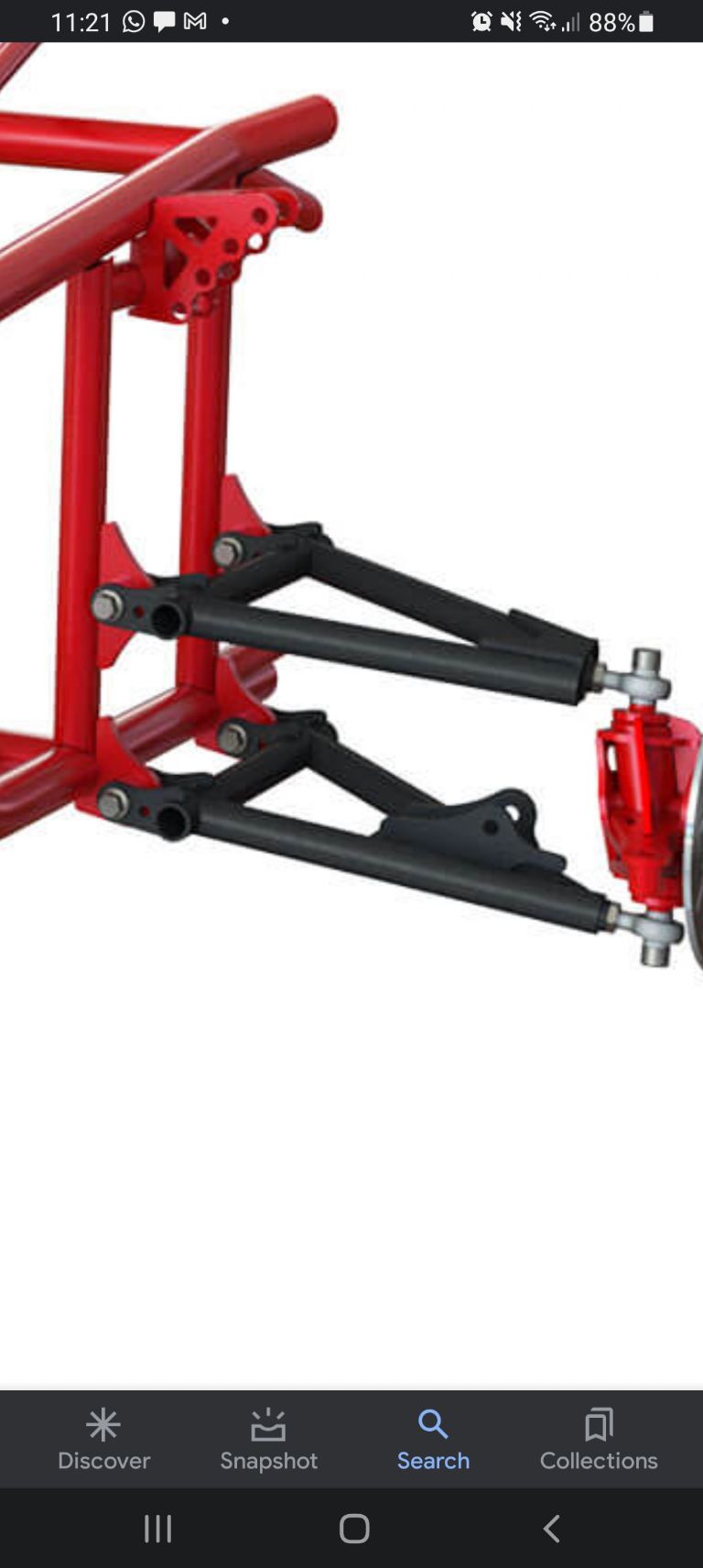

So I'm in the process of building a gravity soapbox race car. We have gone for double wishbone suspension. A bit like the screen shot in the picture. This is not my design but have added it to help my description. In the joint where the wishbones are bolted through the brackets I was thinking of adding a couple of 'plastic' washers to help reduce any slop but still allow articulation.
Is this a good idea a what would be the best choice? Nylon 6 or 66 or acetal are all coming up when I Google it. Any tips on turning this sort of material would also be appreciated.
Thanks Colin

Urethane (aka polyurethane) washers are available off the shelf. Widely used in automotive suspensions etc.
But if you make your own, Delrin should work ok. Machines ok with a sharp HSS toolbit. Nylon too, and not so stringy swarf getting caught round the job etc.

Material as Hopper has suggested or try glass filled PTFE. I have used glass filled PTFE on motorcycle suspension with good results.

If you want buy try Igus. Plenty of choice of material for both bearings and washers, some at low prices.

The Locost home build cars used "plastic" top hat bushes for the wishbone pivots., although these may be too large for your racer..
It may be worth exploring "Locost cars " on Google, to find a source.

For the use a soapbox racer will get, is the complication of bushes really necessary?

If it was me, I’d use nylon. Either 6 or 66, not much in it, but 6 if there’s a choice because it’s slightly tougher.
Acetal is a little more brittle and not quite so good wear resistance.
Nylon 6 can absorb moisture (presumably it’s outdoor) which doesn’t cause any issues that should concern you, except they can swell slightly. But we’re talking small dimensional changes, so just don’t make it too tight to start. Nylon 66 absorbs less if high accuracy is an issue.

I have used Nylatron GS for suspension bushes with good results. It's Nylon with a Molybdenum Disulphide filler. Has better wear resistance than 'ordinary' Nylon in my experience. Machines nicely with a sharp HSS tool.

I would recommend the Nylatron GS that Stueeee has suggested. I have used it for bushes and have also had very good results. Machines without too much trouble.

You'll find the brackets can deform enough to take out any slop when you tighten the bolts.

Thanks for all the input. Give the use I definately dontvghink they are strictly needed and I certainly could just buy them but I'm trying to kearn machining and I'm always looking for opportunities to try something new.

I was hopingbthe nylon was going to reduce the possibility of binding. It sounds like this could still be an issue with nylon in the rain!

As per Hopper's post - delrin/acetal was my first thought. Available, inexpensive and machines to a silky finish with a sharp tool.
